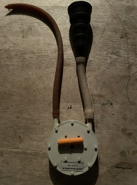

I use the cheapest water-powered stirrer there is and think it’s the way to go.
