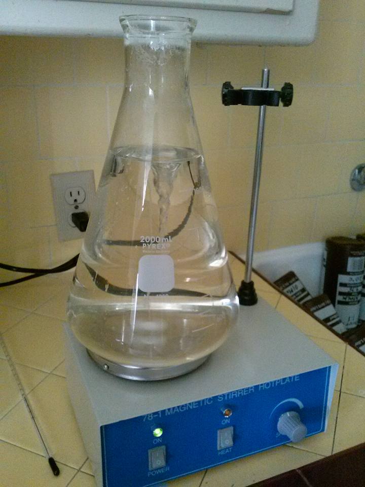

This is probably old news to most, maybe.
I recently, as in yesterday, decided to try out a a magnetic mixer/hotplate. I find proper mixing of powder chemicals in order to keep oxygen contamination to a minimum and achieve 100% dissolution, tedious and time consuming. I usually let the mixture sit overnight in the gallon Datatainer to insure all the powder is completely dissolved. However, I want to know before I transfer the chemicals to the Datatainer that I have %100 dissolution.
Long story, short,...
Mixing film processing chemistry just got a whole lot more precise and, as a side benefit, easier for me; 100% dissolution of chemistry at the perfect temp with minimal oxygen contamination in short order. Set it, forget it, do some chores, come back, transfer to Datatainer.

Nice, isn't it? One additional advantage over manual mixing is when one is diluting solutions. It takes a LOT longer to fully homogenize dissimilar solutions than one may think.
For example, when the addition and dissolution of dry chemicals into a new solution is complete it's usually time to bring the maximum volume up to its final level by adding water. Do this with an automated stirrer, in a beaker with a light shining into it, up against a black background, and watch how long it really takes before you can no longer visually distinguish (by refraction) the two distinct solution types.
It's an eye-opener for anyone who regularly mixes the dilutions by hand with a half-dozen quick circles, then pours the still-differentiated solutions into multiple storage bottles for later use, assuming the mixing was complete.

Once owned and used, these seem invaluable and I am totally reliant on mine. One note: Resist the urge to use excessive rpm's as the cavitation can drive air/oxygen into the solution and have an effect on the activity life of the solution. On large, bulky projects like Xtol 5L mixing, I switch to a gallon glass thumb jug and gently roll it on its side until I am certain it is fully mixed. BTW, I then use it at adjusted dilutions from the mixed-to-gallon stock.
I heard mention of "cavitation" while shopping for a unit. Does it really increase the surface's exposure to oxygen all that much more than without cavitating.

I looked for the least expensive mixer/hotplate on Amazon and found what appears to be an unbranded Bipee for $90.
I've only used it once but it didn't have any immediate defects. When it first heated up there was the usual smell that is emited from new equipment that has a heating element.

Corning units are, for our purposes here, kind of the Rolls Royces of magnetic stirrers/hotplates. I have this unit as the full kit purchased new, but got a very good deal and didn't pay near the catalog price you see in the link. The kit came with the closed loop feedback external temperature controller, which I have never needed. But I have tested it with water and it works uncannily well.
This is a precision piece of lab equipment and is probably overkill for an enthusiast darkroom. But for the one-off deal, I would not have selected such a higher end model. However, automated stirrers in general are not overkill. Other brands and/or used units are plentiful and not overly expensive. Check the Ugly Auction Site.

A magnetic stirrer/hotplate really is a required piece of kit. I can't believe I didn't know about these. The whole set it and forget it aspect is key; chemicals mix themselves whilst mundane darkroom (or other) chores are not being put off. Proper lab glassware has been an eye opener for me as well. It is, after all, "chemistry" and when treated as such one develops and maintains a certain level of discipline.

I need help from those of you familiar with a magnetic stirrer.
I dug one out of my pile of "stuff" and tried it with several bar stirrers. And they did not work/spin, the stir bar was just shaken or the whole bar was dragged around the beaker. However, a round one with a round flat magnet did work/spin.
On opening up the case, I found that the magnet on the motor was a flat donut shaped magnet, not a bar magnet. So a different magnetic field, and that is probably why my bar stirrers were not working. Anyone know where I can source a disc shaped stirrer that uses a flat disc magnet.
