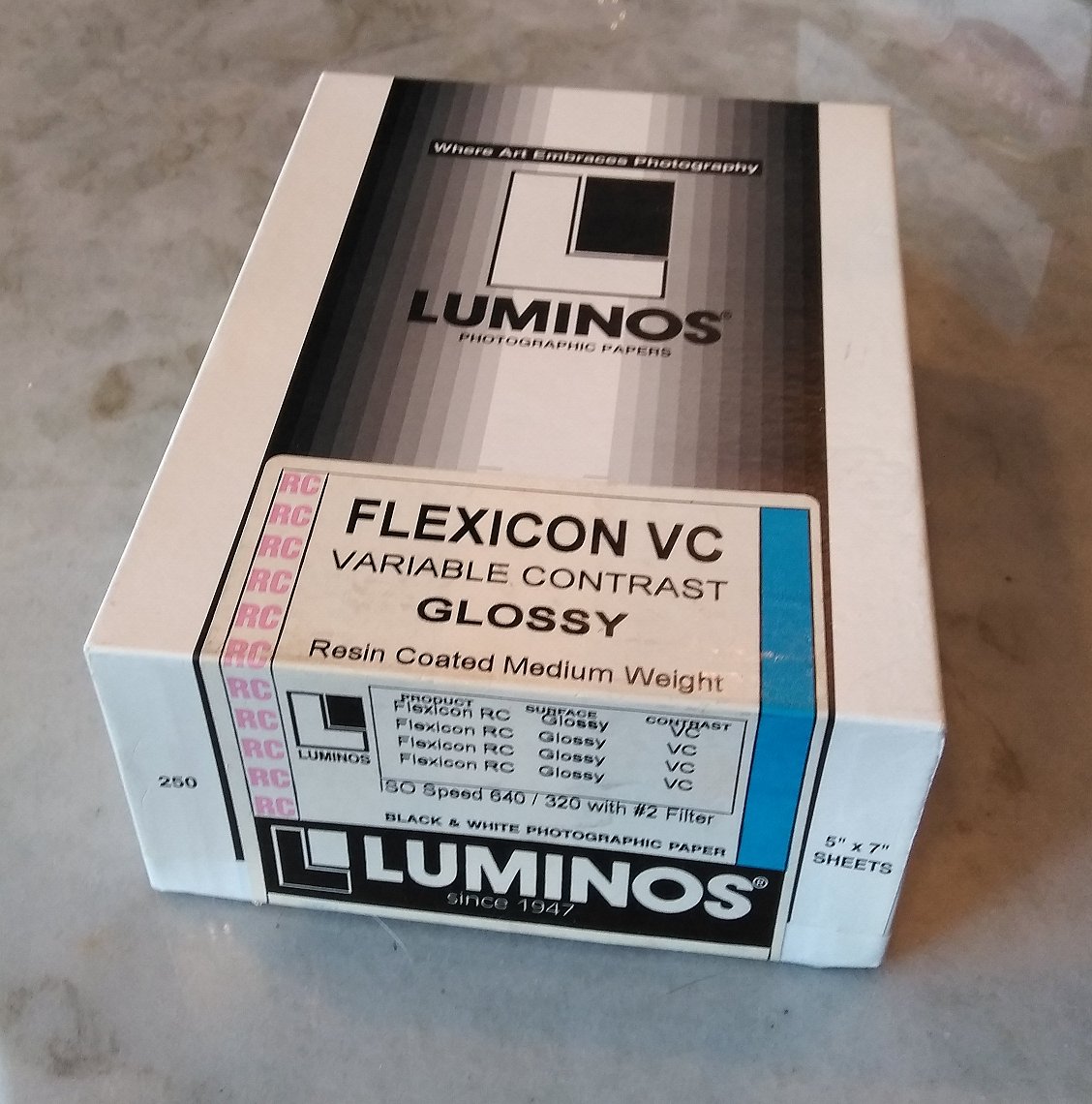

Shot in the dark, but I was wondering if anyone knew who was the manufacturer of this paper when made in Spain. Did AGFA have a plant there maybe? The label resembles an old AGFA label on a box of Brovira I have. My understanding is Luminos was a brand and never a manufacturer. I may never find another box of old paper like the one I just opened, but it would be nice to know who made it and keep my eye out.
