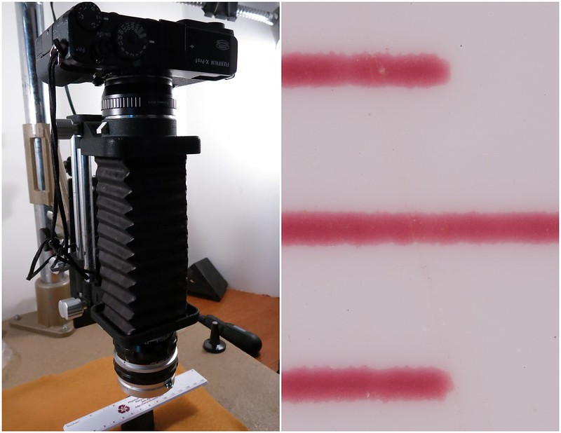

Reversed normal and wide-angle lenses produce better close-up and macro photos than reversed telephoto lenses.
I use a Nikon BR2 reverse lens adapter between the bellows and a 28mm f/3.5 Nikon wide-angle lens to capture images with a reproduction ratio up to 12:1 as compared to a reproduction ratio of 1:12 when the lens is used in its normal position.
For example, if I can fill the frame of 24x36mm image with 3mm of ruler, the magnification is 36 divided by 3 which equals a 12x magnification.

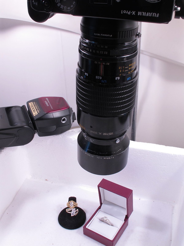

Just how much magnification are you looking for?
As I understand it, reversing the lens not only gets you more magnification but also gets you flatter plane and supposedly better image?
Unfortunately I didn't document this image well and don't remember other then I used a macro on a bellows and reverse the lens to get even more magnification.
Untitled by Les DMess, on Flickr
And you can stack bellows and extenders.
Fuji 100-23 LX-35 by Les DMess, on Flickr
Of course if you need more magnification then microscopes might be even ore useful.
Microscope by Les DMess, on Flickr
Biggest problems with getting more magnification is applying proper lighting on the target as well as having a bright finder and using a focusing screen with no split image as it will be such a nuisance when it blacks out. If you are using one of those split image screens that never black out - like the ones used on a Canon New F-1 and Nikon FM3A, it will be impossible to focus as everything looks in focus even when they are not.
