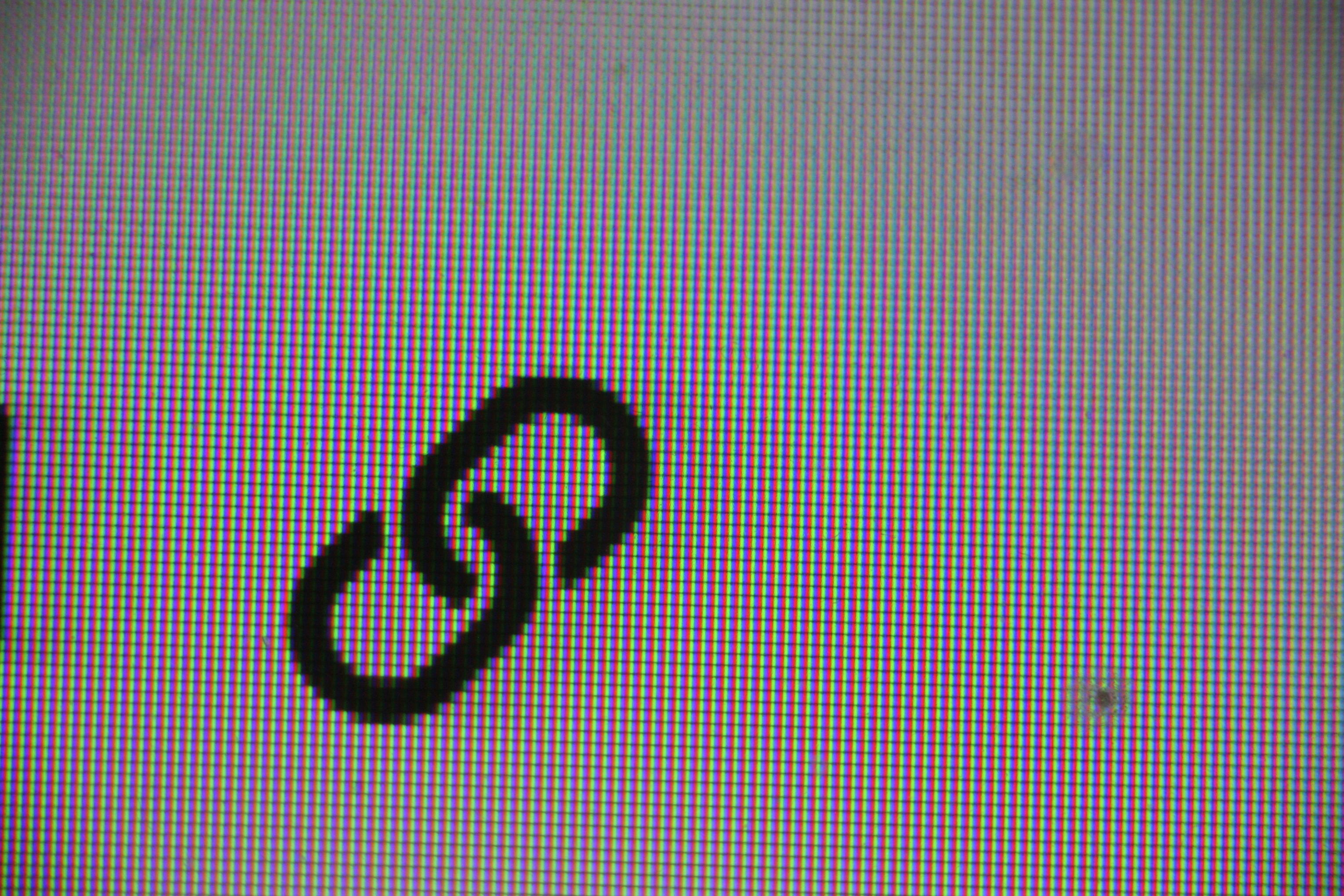

My Vivitar Series 1 90mm lens is too heavy for me to handhold now and this lens is close to that point. Attached 1:1 shot of LCD screen.
