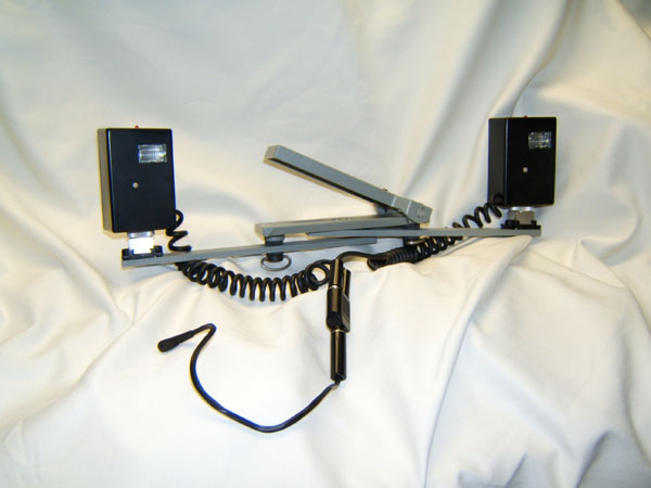

I hope someone can help me out. We have every spring Orchid show in town.Three years ago I made a flash unit from one way cameras and Manfrotto #033 flash holder with good success. With low level of light they provide, you can get very close without blowing out the colors. That was with 35mm Canon equipment. I would like to use my 4X5 camera. I have Toyo45 and Graflex 4X5. Would one of this cameras be OK to use. I don't have macro lenses. I do have 90;135;150;180;210;240.250 and 270 for my 4X5's. How much bellows do I need with this kind of images?
Thanks in advance Greg

The magic formula you need is rear node-to-film distance = f*(1 +m). f = lens' focal length, m = magnification, and for most LF lenses the rear node isn't far from the diaphragm.
Either camera will work well if you're shooting straight ahead. The Toyo probably offers more flexibility.
Which lens to use? Can't answer with the limited information you've provided. What have you got (make & model as well as focal length)? What magnification do you want to shoot at?
About exposure. GN arithmetic will give you the effective aperture you want. GN/(flash-to-subject distance) is it. The GN of two identical flashes = sqrt(2)*a single flash's GN. To convert effective aperture to the aperture setting to use, aperture set = effective aperture/(1 + lens' pupillary magnification*m). For most LF lenses, pupillary magnification = 1.

Thanks Dan
The lenses I have are:Schneider Xenar135/4.7,Componon 135/5.6;150 Syronar-N 5.6;210 Fujinon-W5.6;Schneider Xenar 240/4.5(Linhof);Schneider tele-arton 270/5.5. I think Super-Angulon 90mm is to wide for closeups or not?I would like to fill the frame with the flower. It is hard to shoot when there is 6-7 plants sitting on the display table without having distracting background.

Hmm. Don't take it too too personally, but you're nuts.
Filling the frame with a single bloom will often require you to work above 1:1. This ain't easy and there's very little depth of field. To learn more about what you're up against, buy a copy of Lester Lefkowitz' book The Manual of Closeup Photography. Out of print, available used through, in alphabetical order, www.abebooks.com, www.addall.com, www.amazon.com,and occasionally on eBay.
Not knowing more, I assume that you have 300 mm of extension +/- to play with. If that's so, your best bet is probably the Componon. I expect its in a #0, if so you can easily switch the elements around (front to back, back to front) when working above 1:1; up to 1:1 it will work better facing normally.
The SA will get you to a little above 2:1 and, again, it should be reversed above 1:1. Might work well enough, worth trying.
You might consider buying one of the cheap ex-MP-4 75/4.5 Tominons and an equally cheap ex-MP-4 Copal #1 Press with no diaphragm to hold it. These things turn up often on eBay, you're looking at at most a $80 expenditure. And that will take you to around 3:1. Or maybe even an ex-MP-4 50/4.5 Tominon, will get you to 5:1 but won't come close to covering 4x5 near 1:1. I've had both lenses; they're not the best, which is why mine are in the past tense, but they're also good enough.
Don't even think of using your 150 Sironar or longer lenses, your Componon is the best tool you have for this job.
FWIW, I went up to 2x3 because I was dissatisfied with flower pictures taken on 35 mm. On 35 mm, I could get good detail in the bloom OR a nice shot of the bloom in its setting. I can often shoot 2x3 at a magnfication no higher than I'd use for just the bloom on 35 mm and get both. In my limited experience, the benefits of shooting on a format larger than 35 mm above 1:1 are often illusory. Read Lefkowitz.
Cheers,
Dan
