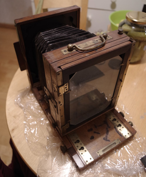

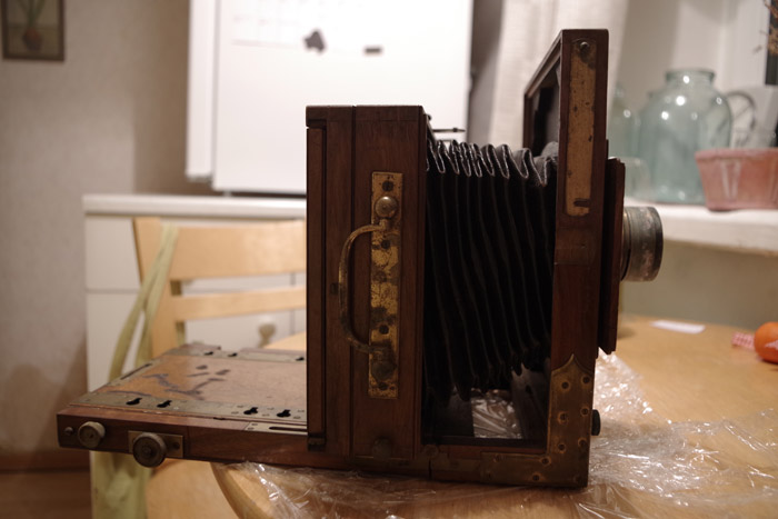

Accidentally found a 5x7 (or most probably 13x18cm) camera for cheap. Having used a relatively modern 4x5 with paper positives for a while now I'm excited about this larger find, probably manufactured in the end of the 19th century.

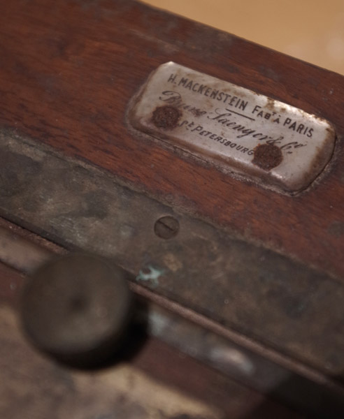

So, the specs, the text I've been able to read. The sign on the camera reads: "H. Mackenstein Fab't a Paris. Bruno Laenger (Saenger?) & CO. St. Petersbourg."

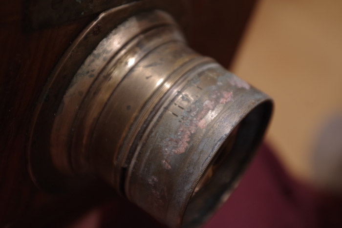

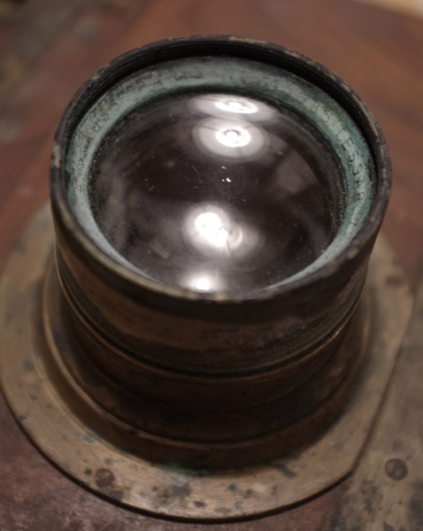

The lens: "Tessar Zeiss 1 : 4,5 F - 18 cm Bte E. Krauss Paris No. 148885 (?)".

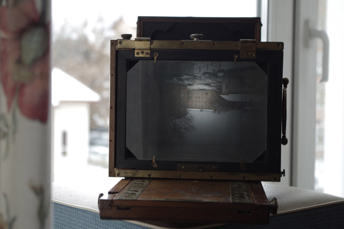

It seems that the camera has been sitting on a loft for a while - the front is dirtier than the other sides and the apparatus has a quite strong unpleasant old smell to it. It is otherwise in good order: bellows do not seem to leak, everything kind of moves, the back rotates, an image is produced on the ground glass onto which other format guidelines have been drawn hinting the possibilites. The aperture moves smoothly although the ring is not attached to it anymore, but this seems to be easily fixable. A lot of questions regarding the restoration arise though: how to clean the outside of the lens (soda and lemon juice?) and whether the inside can be done at home too or would it be to difficult? Would it be with a possibility that I won't be able to reassemble the lens or are these generally simple lenses that I can just start unscrewing from the "logical" point? Is it possible to attach a shutter which it seems to miss right now?

This camera is on this page : Collection-appareils.
It's a Série III A, on the right with rear tilt.
You can unscrew the lens, it's easy to reassemble. You clean the faces with special lens cleaning paper and some humidity (your breath) ; be careful...

Lenses scratch quite easily. Treat it like you're trying to get a bug out of your eye.
There may have been a shutter that slipped over the lens at one point. Look up "Packard Shutter". Or it may have been used with a very slow emulsion and they simply removed and replaced the lens cap.
That tag looks sort of new-ish to me. What is it made of?

Can't really make anything out of the tag. Feels slightly plasticky yet doesn't look like it too much. Can't really guess.
