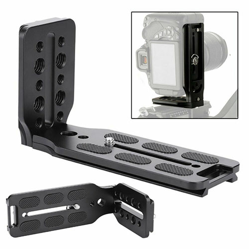

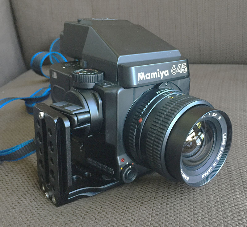

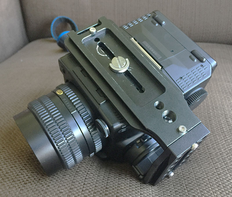

I'm not a big fan of the left hand grip, which I find overly bulky and makes the camera uncomfortable to carry as the thick bottom bar bumps against the body. This is my solution (shown on a Super) for a right hand grip... It allows a variety of grip positions, and I can wind using my thumb and forefinger on the folded crank. Plus, there are horizontal and vertical tripod mounts built in :smile:. I may try making a grip that slides onto the short vertical dovetail section. Available on ebay for about $15 shipped.

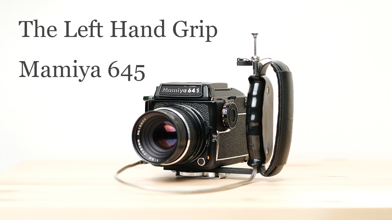

On a separate note, can anyone identify this particular grip with a cable release featured on this photo for the Mamiya?
I cannot seem to find any info on it and would love to add one to my cameras.

That looks to be something someone other than Mamiya has put together - possibly incorporating design elements or parts from a Mamiya grip that doesn't have a "trigger".

I think it's based on a Mamiya TLR grip, with the shutter cable possibly added. I believe that the locator pins on the bottom of the Mamiya 645 and the TLRs are in the same place.
