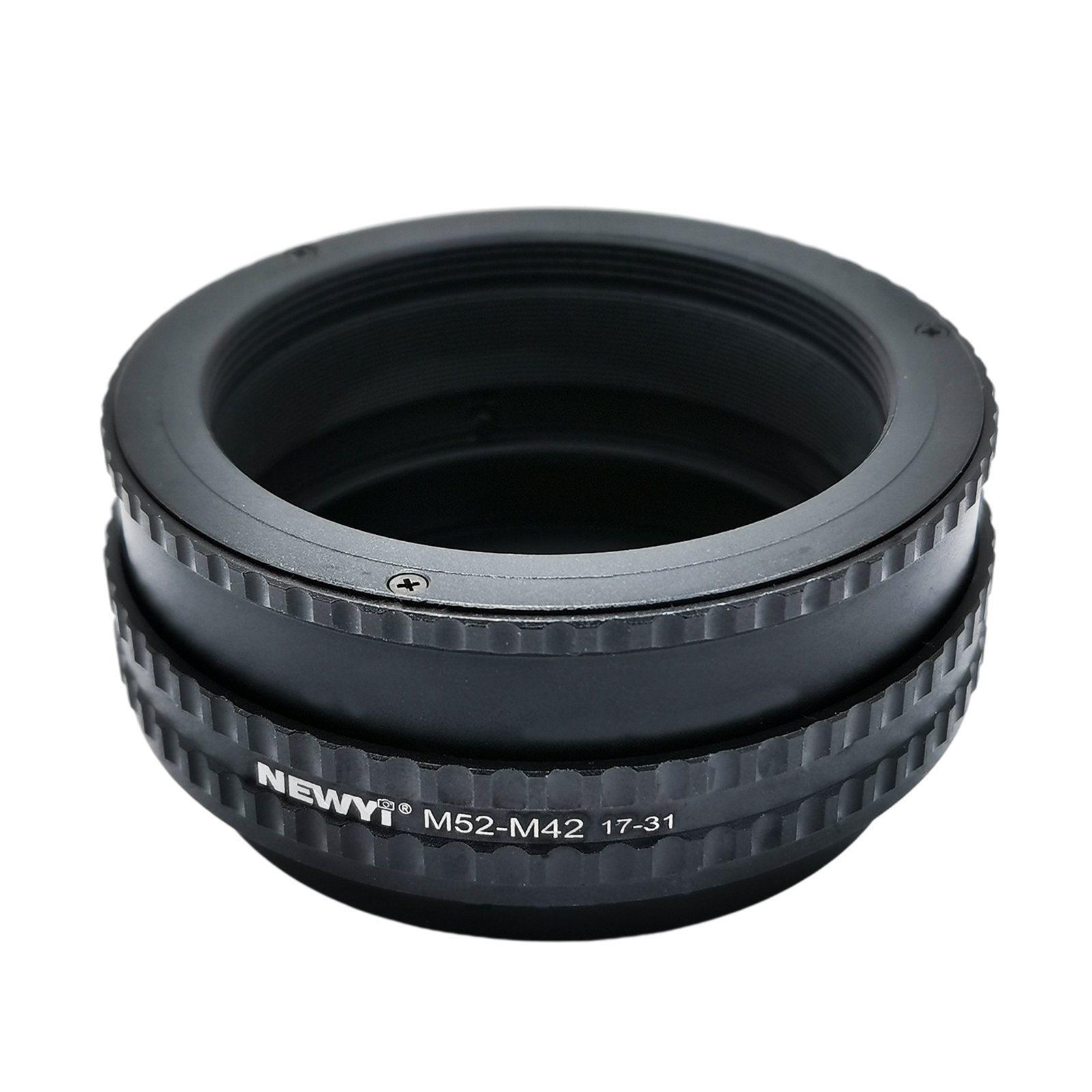

I bought a focusing helicoid for a project. This has a M42 male thread on one end and a M52 female thread on the other end. The M42 is no problem as this just takes a standard rear lens cap.
I had never encountered a M52 before. It seems there are two variations of the thread. One has a .75 pitch and the other a 1 pitch. From the looks of it, this appears to be a M52 x 1 thread. What was the M52 used for? Any suggestions for finding adapters, etc for this thread?

M52x0.75 is a common Filter Thread.
(Keep in mind that "M" basically does say nothing on the pitch. Thus both threads you refer to are likely "M" threads.)
I got no idea what M52x1 was used for in the photo world.
What would make sense in your case though would be a female 0.75mm pitch thread, as then it could be used with respective retro-rings, which by this would act as camera-adapters to that helicoid.

I'd guess M52x1 is a rear thread for some large shutter. Copal/Compur 3?

It is not a filter thread. 52mm x .75 filter rings bind.
According to sizes.com, it is not a shutter thread. This shows a Copal #3 has a 62mm x .75 mounting thread.

On ebay you can find inexpensive focusing helicoids with various thread sizes, mostly M42x1, M52x1, M58x1, and so on. (This is an improvement over the part when focusing helicoids were expensive and hard to get.) M42x1 is easy/useful, that's the Praktica/Pentax etc M42 lens thread mount. The reasoning for the others is less clear, filters in those sizes are M52x0.75 and so, and Copal/Compur shutters don't match.
I don't know where the impetus for these focusing helicals originated but some of it is possibly from the lens adaptation / cine / video market.

M52 is a standard thread on adapters for microscope objectives to be used on still cameras:
But then such adapter only makes sense if the M42 thread would be a male one. The photo at post #1 does not make us wiser on this.
NEWYI -- the name on the adapter -- makes a lot of TV/CCTV lenses, so this is a good guess.
It was not used.
But it seems now a kind of standard (like in our world the T mount) to couple camera-mount adapters to helicoids.

Whatever 52mm x1 is used for, there are various adapters for the thread listed on the evil auction site. I ordered a couple that look promising and should be useable for my purpose.
Interestingly enough, the only camera brand referenced for any of the adapters was Hasselblad.

There are M52, M58, M65 and even M72 helicoids on eBay. They get more expensive probably due to more material required and less demand for them.
I didn't realize they existed until someone told me to look for M52 for lens adaptation solutions. He used rubber tape to make up any gap between a smaller barrel and the M52 threads. For that purpose, the thread pitch doesn't matter at all.
I have one M42-M52 helicoid in addition to an M42-M42 so far.
