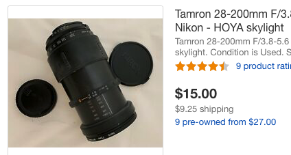

Why not a Nikon mount lens?

I've not come across such a well priced Nikon mount lens in the UK. But yes, if that had been around when I bought the Sirius, I might have bitten.
