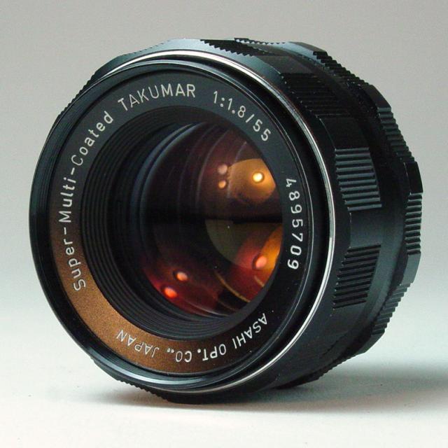

Hi there,
I would like to do Macro shots with my Carl Zeiss Jena 50mm f/2.8 Tessar & Super-Takumar 55mm f/1.8. I never used extension tubes before and could use advices to do a good purchase.
best regards.
