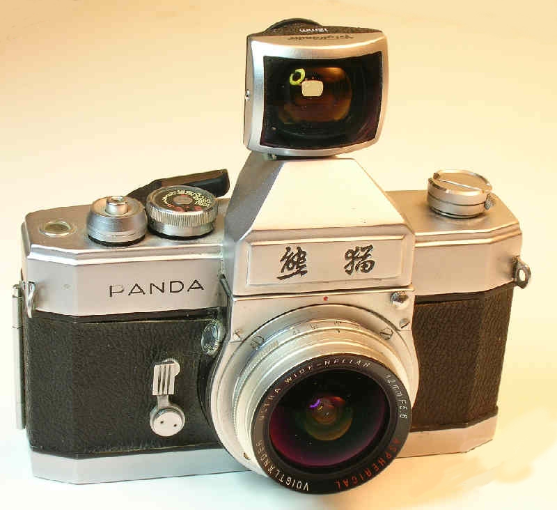

Here's a possible solution -- if you are a "DIY guy". I managed to adapt a Voightlander 12mm f5.6 ULTRA-wide to a Minolta SLR mount.
Your situation is similar to putting my Minolta Rokkor SLR lenses onto my a-mount Maxxum film and Sony digital cameras. There's just not enough space for an adapter to allow the lenses to focus to infinity.
There are, however, Minolta Rokkor to a-mount adapters -- from inexpensive to costly. The cheapest are simply a-mount-to-Rokkor adapters, but they don't allow infinity focusing. I can use these with my LONG Rokkor lens, but I can only focus to a couple of hundred feet -- depending on the lens. I can also use the adapter for close-up work with any lens -- great for macro work.
BUT, there are adapters that have glass conversion elements inside. These are more expensive but allow infinity focusing. They magnify the image from 1.1 - 1.3X (depending an the adapter) and allow infinity focusing.
These are all DUMB adapters, but you could buy one of these conversion adapters for the lenses you want to use, and replace the BACK of the adapter (whatever that happens to be) with an M42 screw thread. You'll need to find an adapter that creates as close as possible the distance that you need -- hopefully a tiny bit shorter -- and disconnect the existing rear mount, and "attach" an M42 mount.
Sounds easy to me -- IF you can live we a slight magnification. EX. a 50mm lens becomes a 60mm lens.

You are correct about the Heliar. but I was able to remove the original lens mount and put a Minolta mount on in it's place. It is NOT a retro-focus lens, so I can only use it on cameras with a mirror lock-up, such as the PANDA in the above photo. That's why there is a separate viewfinder on top of the camera.
