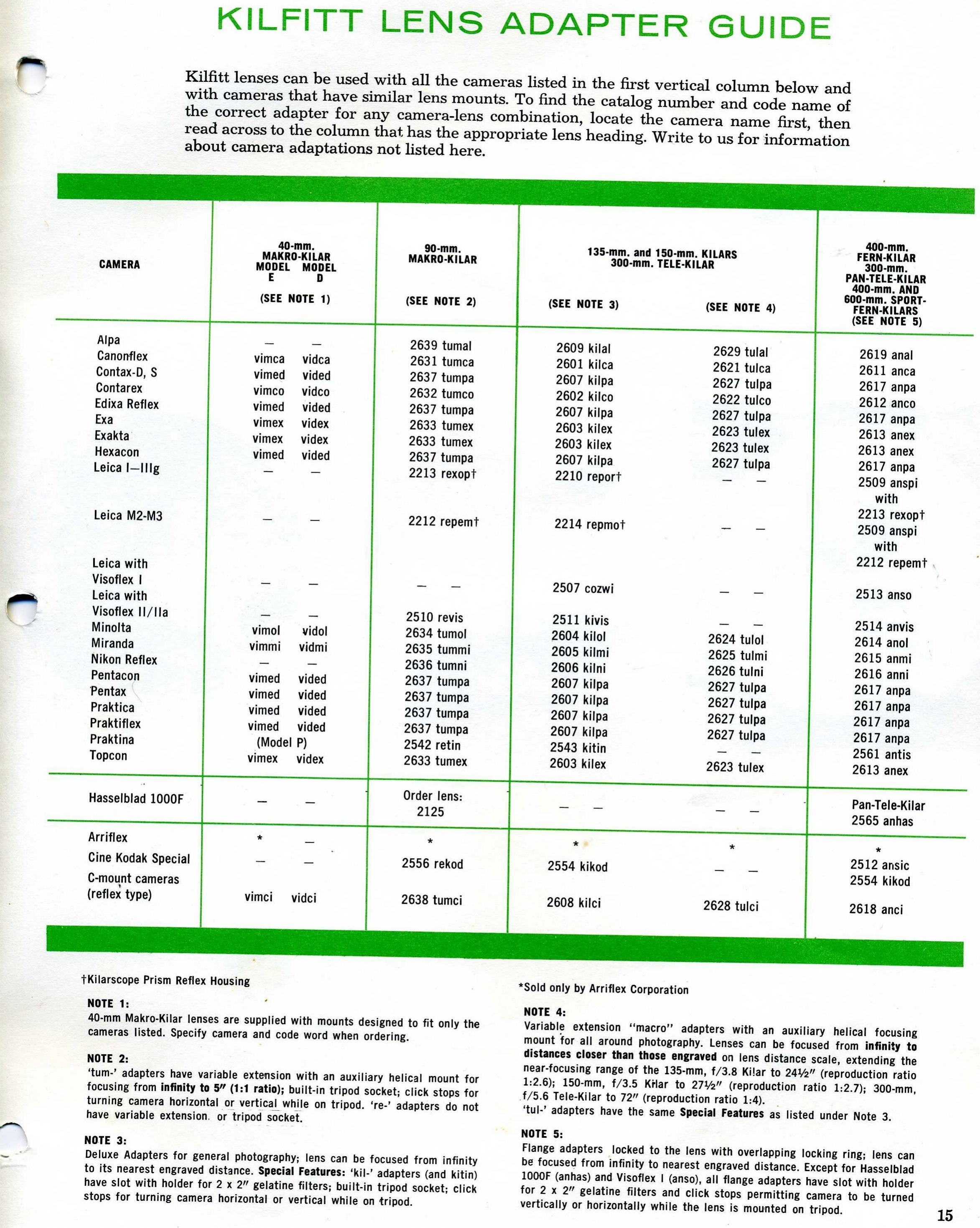

OK, there's a black adapter ring in the box that the lens came with that has "LE-T Japan" written on it. Can I assume this is a Leica M39 to T-mount adapter?

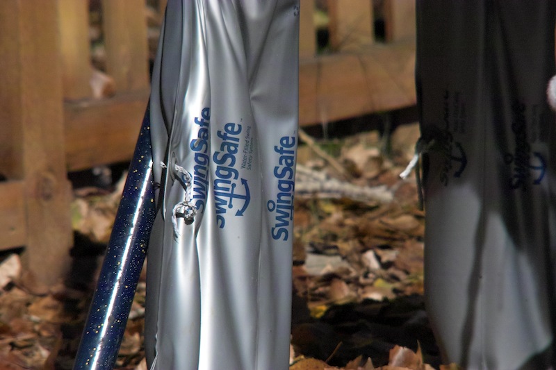

My M42 extension tubes of total of 65mm with the lens adapters does not reach infinity - it's much closer. So I need less length, right? The tube screw into the T end of the adapter, but not very far, since the pitch is different. I didn't go any further when I felt it tightening.
Here's a photo from my SD15 (sorry it's digital, but this will be the easiest way to get it figured out).

Correct, less extension.
If you take the tube out does it go to infinity?

That's interesting, but I'm not sure how to read it. It says for Pentax I need "2617 anpa". What is an "anpa"?

"2617 anpa" is the code for the mount. The "anpa" is just the letter part of the code, probably means something to the parts/order department when they were still in business. It will look something like an extension tube. It should have "Kilfitt" and the code stamped or printed on it somewhere. These adapters are quite difficult to find and can be expensive ($100-200 just for the adapter) but they do show up from time to time.
