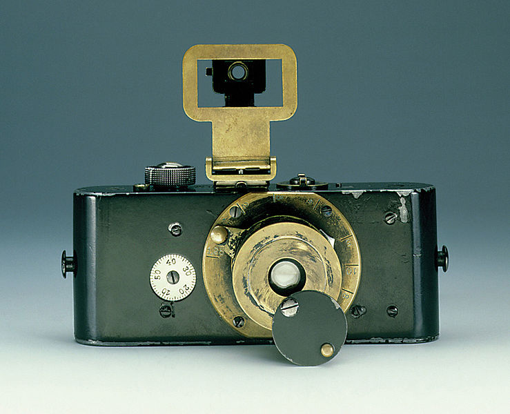

The M3 eyepiece rounded corners are reverence to the Ur Leica and visual culture of those days.
The front is rectangular but eyepiece is circular and kinda crops the corners when You look thru, its a feature that many other legendary cameras have.
