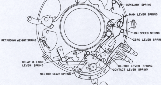

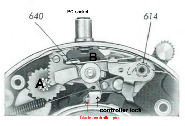

All shutters use a timing mechanism to delay the opening of the shutter on all but the X setting.
Synchro Compur : cocking the shutter puts tension on the main setting and in the M position the pictured delay mechanism locks the blade controller from moving until the delay timing A moves the controller lock out of the path of the blade controller. Lever B is pressed against the center contact closing it and firing the flash then the blade controller is released allowing the blades to open.

Graflex Graphex/ Wollensak Rapax full sync delay drawing. there is a coil torsion spring in the mechanism, similar to a watch main spring.
Other makes of shutters will have a delay trimming mechanism that functions similarly.
