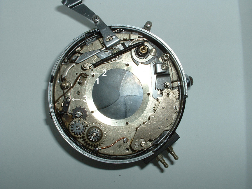

The 10k resistor isolates the right bipost pin from the shutter case. The left pin is connected to the right bipost pin when the shutter blade controller (1) reaches the end of its travel, shutter blades full open, and contacts the end of the copper contact (2) that is connected to the left bipost pin. At the same time switch (3) contacts are closed connecting the right bipost pin to the left bipost pin triggering the flash.
With the resistor bypassed the bipost pins are connected when the controller (1) reaches the end of its travel triggering the flash. Switch (3) is no longer affecting the triggering.
