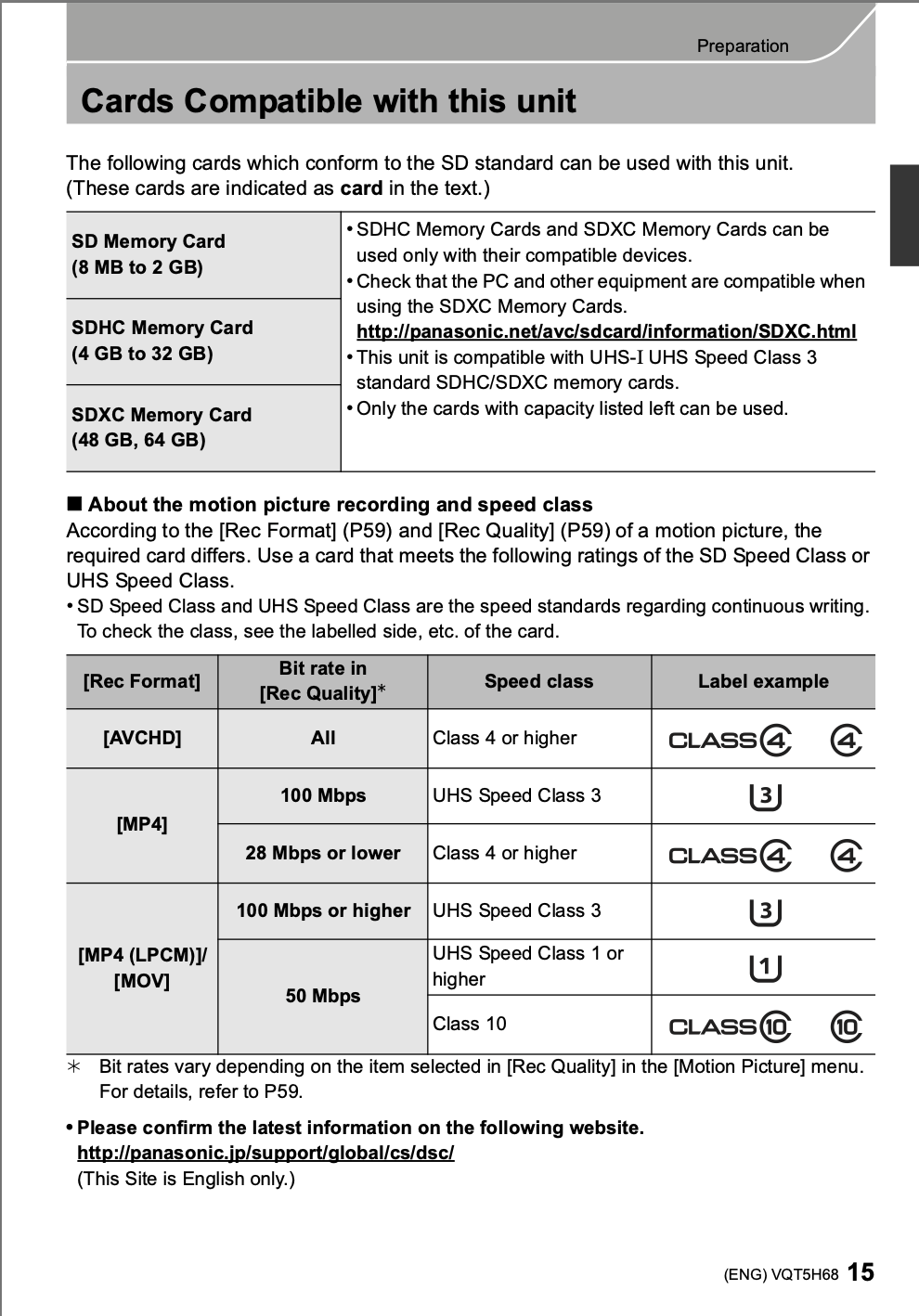

I found this in an online Owners manual for a GH4, but you should confirm that info is correct for your exact model camera. Fuji actually recommends certain brands of SD cards, but apparently Panasonic does not?

Many devices can only use a card up to some maximum capacity. According to the manual screenshot above, it can use up to 64 GB SDXC (I think any card of 64gb and up is SDXC, not SDHC). If you use a larger card there will almost certainly be issues. Try using a plain old name-brand SD card, no adapter, of 32gb or less. You might have to buy it used, which rarely matters. It would probably take you months to fill an 8gb card unless you shoot a lot of video.
It almost certainly is not the batteries.

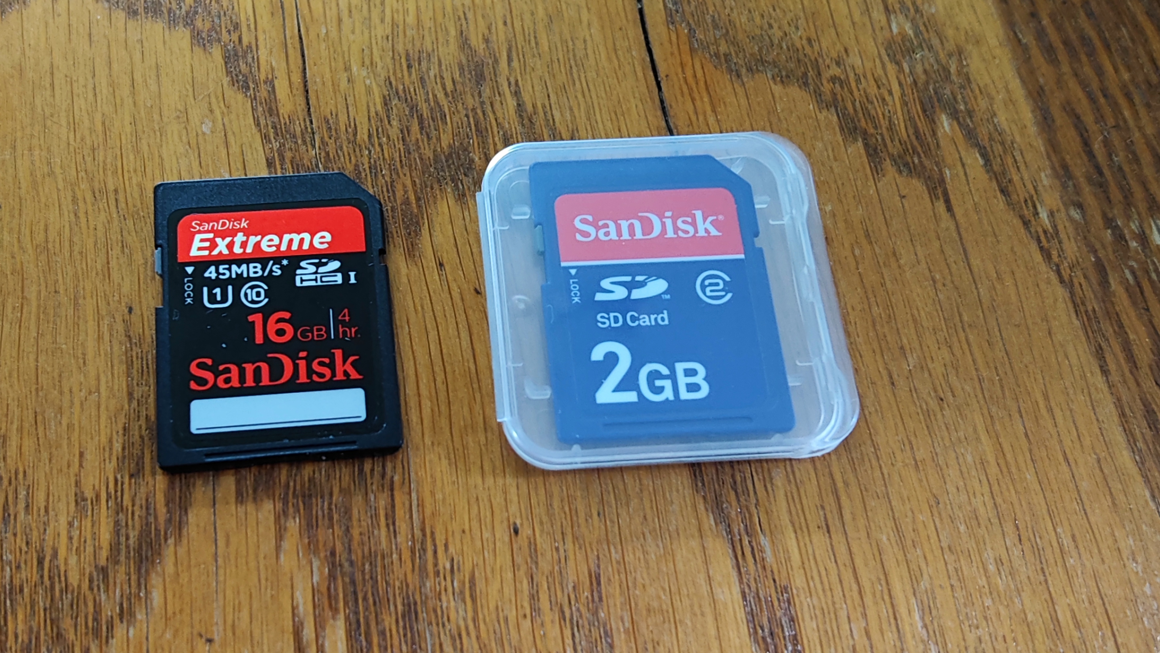

I ordered a regular SD card, 16gb U3. I think it was listed in the above list. Wish me luck that it will fix all issues :D

I used these 2 cards now and get exactly the same problem. When entering gallery it freezes the camera.
Will next try to clean inside slot if i can reach in there
