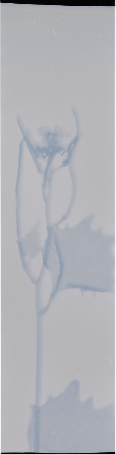

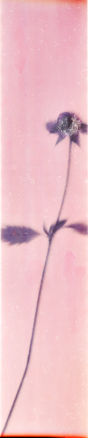

Hi, I have played with lumen printing for a couple of years, and now I would like to try exposing film instead of paper. I already put a piece of Fujicolor 200 with some leaves on under a piece of glass, and I plan to fix it in ordinary fixer (for b/w film) later today. If a picture is formed, perhaps I can print or scan.
Have anyone of you tried this? Should I use negative or positive film? Fixing as planned, or otherwise? Thanks for any advice!
/Erik

jnanian, thanks for your reply. If I read your blog correctly, you expose the film for hours in the sun, then you scan it before fixing, is that right?
/Erik

I tried again this morning, with a piece of the same film (fujicolor 200) and a piece of Tmax 400. After fixing they both have faint pictures. I'll show you as soon as they are scanned.
Erik Petersson
Jan 10, 2006
787
Stockholm, S
170612.jpg 170622.jpg Hi, here are the filmstrips after fixing. They pink is Fujicolor, the grey is Tmax 400. This might be worth trying more.
The scanning software is doing a lot of interpretation of course.

hi erik
yeah you scan before fixing, at least that is what i do
but i don't have a fluid swap with plants, just an image stain in the camera.
have fun!
john
