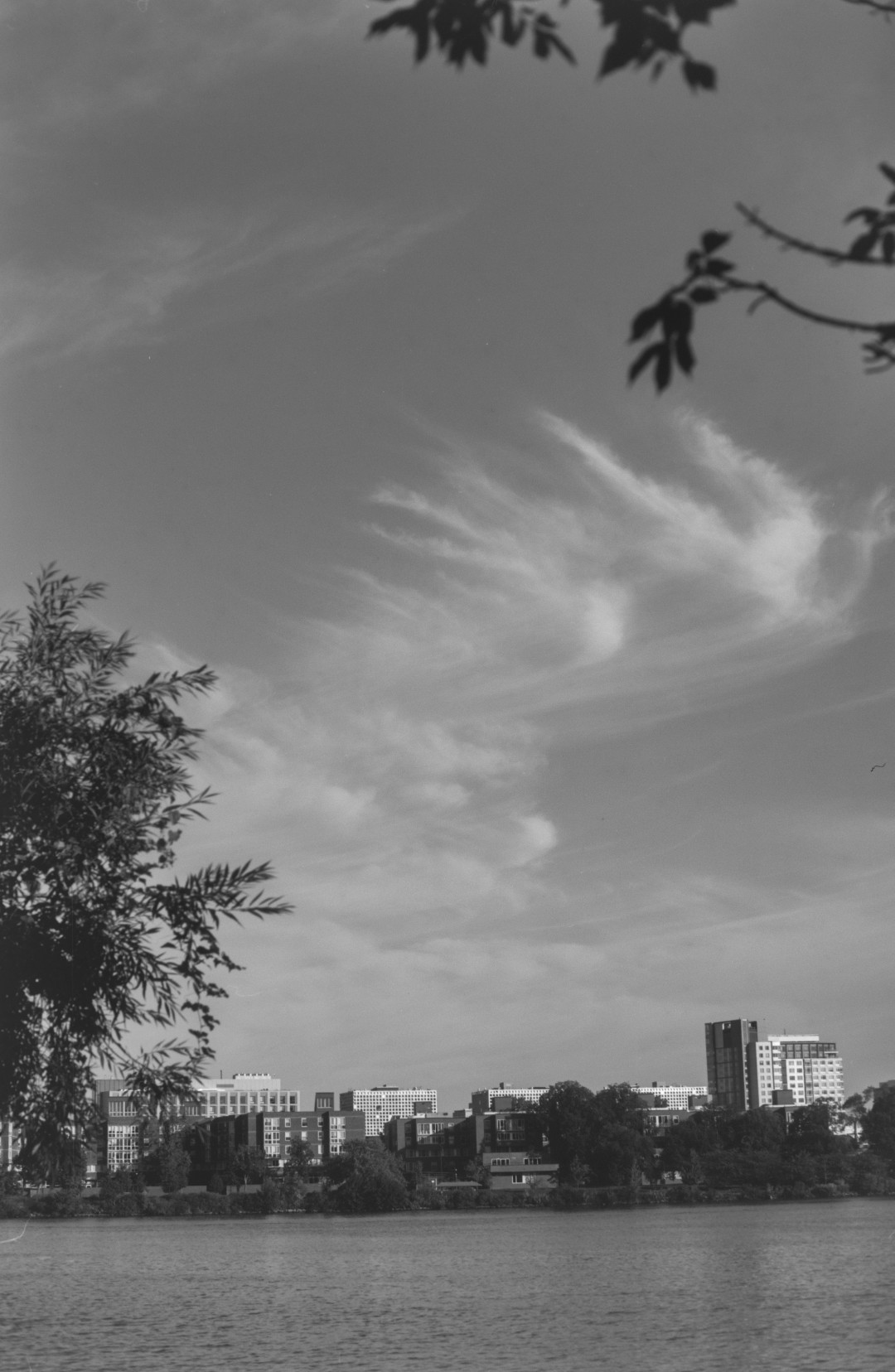

I bought it before tariffs kicked in, 50 some dollars, from Aliexpress. Shot it at ISO 6-12. Use C41 developer to tame high contrast.
That's interesting; despite the liberal exposure, it seems that shadow detail is still rather scant.
it got worse from there.

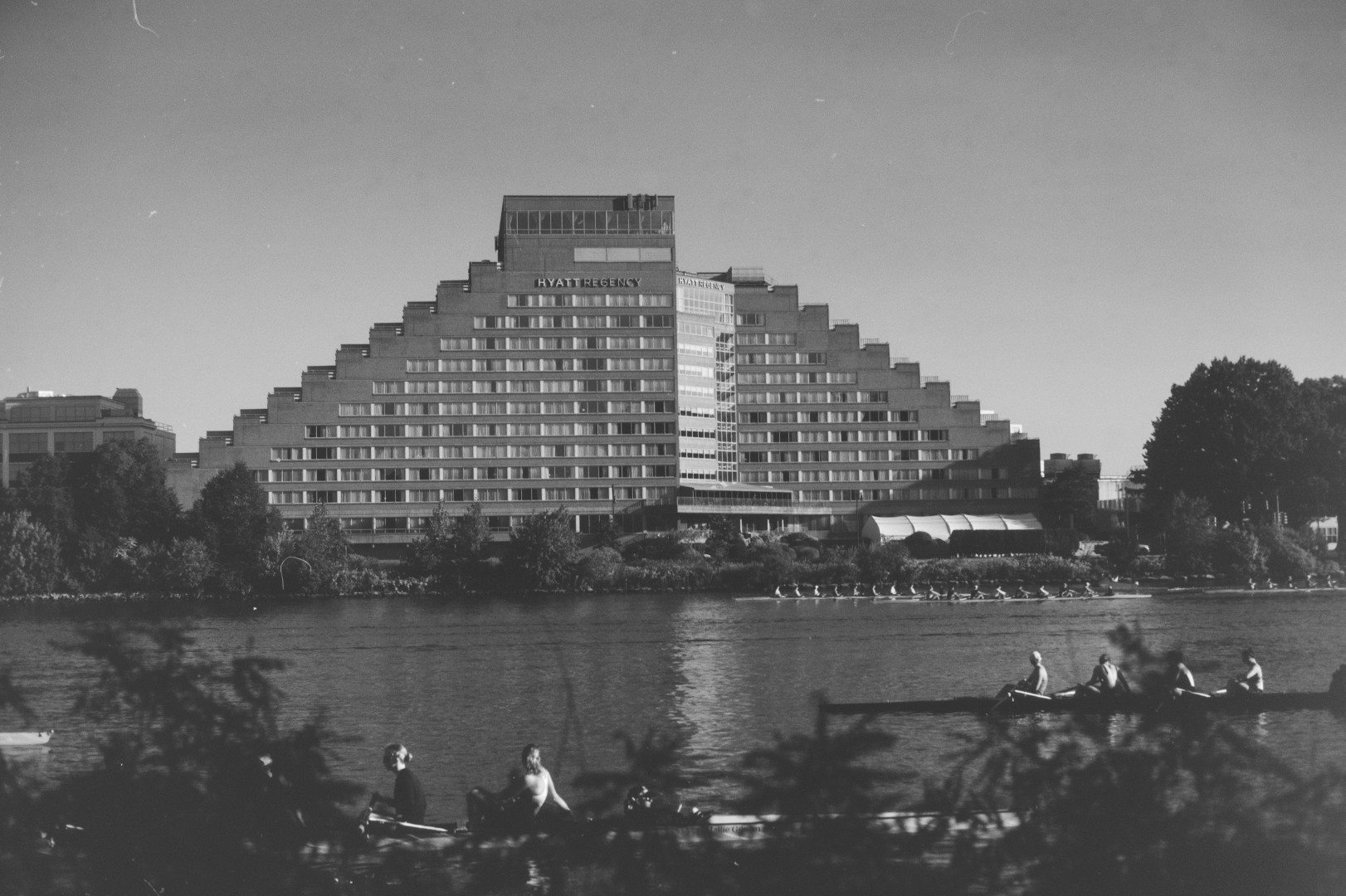

If that's indeed exposed at EI6-12 and metering wasn't exclusively based on the highlights, it seems that the ISO50 rating is rather overoptimistic.
There's an odd light spot/edge in the bottom right corner of the second example; what's the story behind that?
it is time to check light leak in my old Canon Ftb, no such light spot when I used the same film in Olympus OM1
Could it be related to scanning/digitizing? If it were a light leak, I would have expected shadow detail to be locally enhanced as the leak would have acted as a fogging exposure. I see no sign of this.
I know it's a lot to ask, but is there a possibility we can get to see a photo of some of the negatives against a light table? This helps to determine how much shadow density there actually is in the negatives. Future users of the film can use this to their advantage. Thanks in advance!
Interesting thought for sure!
ok, checked the negatives. It was my scanning issue, not camera light leak. thanks for catching that.
also. the film base is clear.

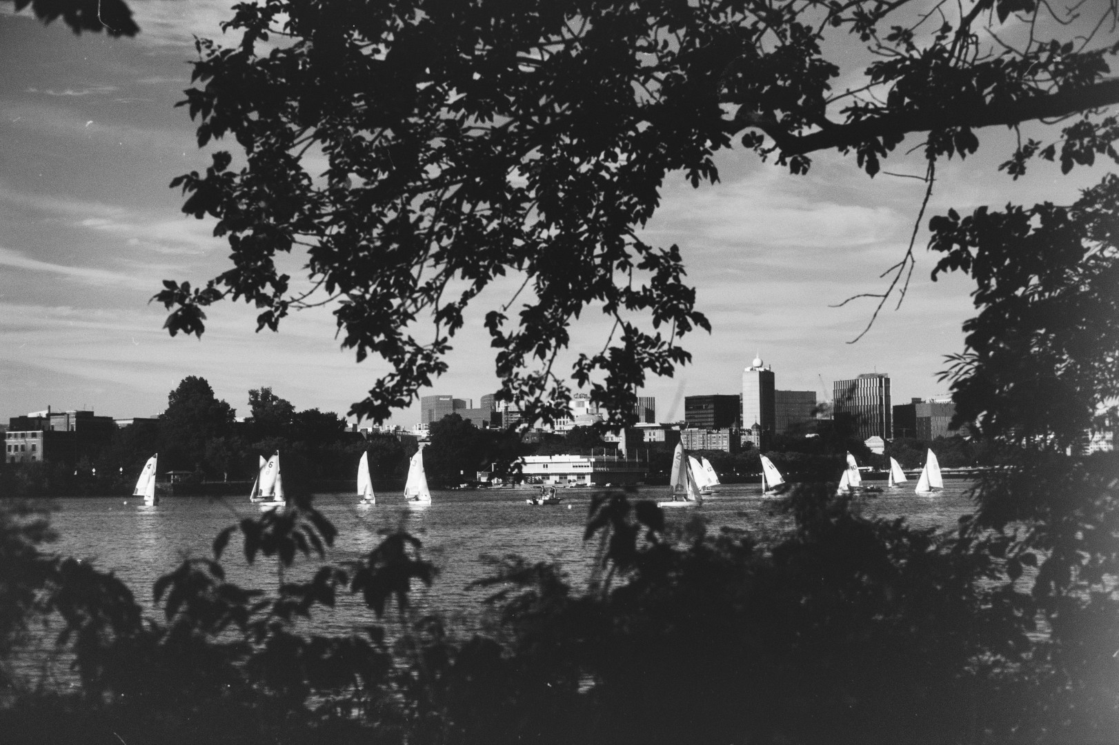

Finally, earlier samples were from a roll underexposed, iso 12-20. Here is an example from a better exposed roll, iso 6.
It could be the developer.
I'm not too sure about that. Whatever developer was used here, it did produce an image. If there would have been exposure in the shadow areas, surely it would have resulted in silver density. If there really is a significant difference in exposure between the frames, you'd see that reflected in differences in shadow detail. I suspect that it has to do with how the scenes were metered.
Thanks for the follow-up; I must be honest - I don't see much difference with the former ones in terms of exposure.
The reason I think the last one was better exposed was because the negative was much darker in the sky. (The difference between the two rolls is quite obvious, one is much thinner than the other overall.) I did try hard to adjust the curves, using photoshop, of the first two images. You are right in that the dark areas don't look different. Your insights? Maybe iso 6 is not worth the trouble? Still playing with this film and inputs appreciated.
