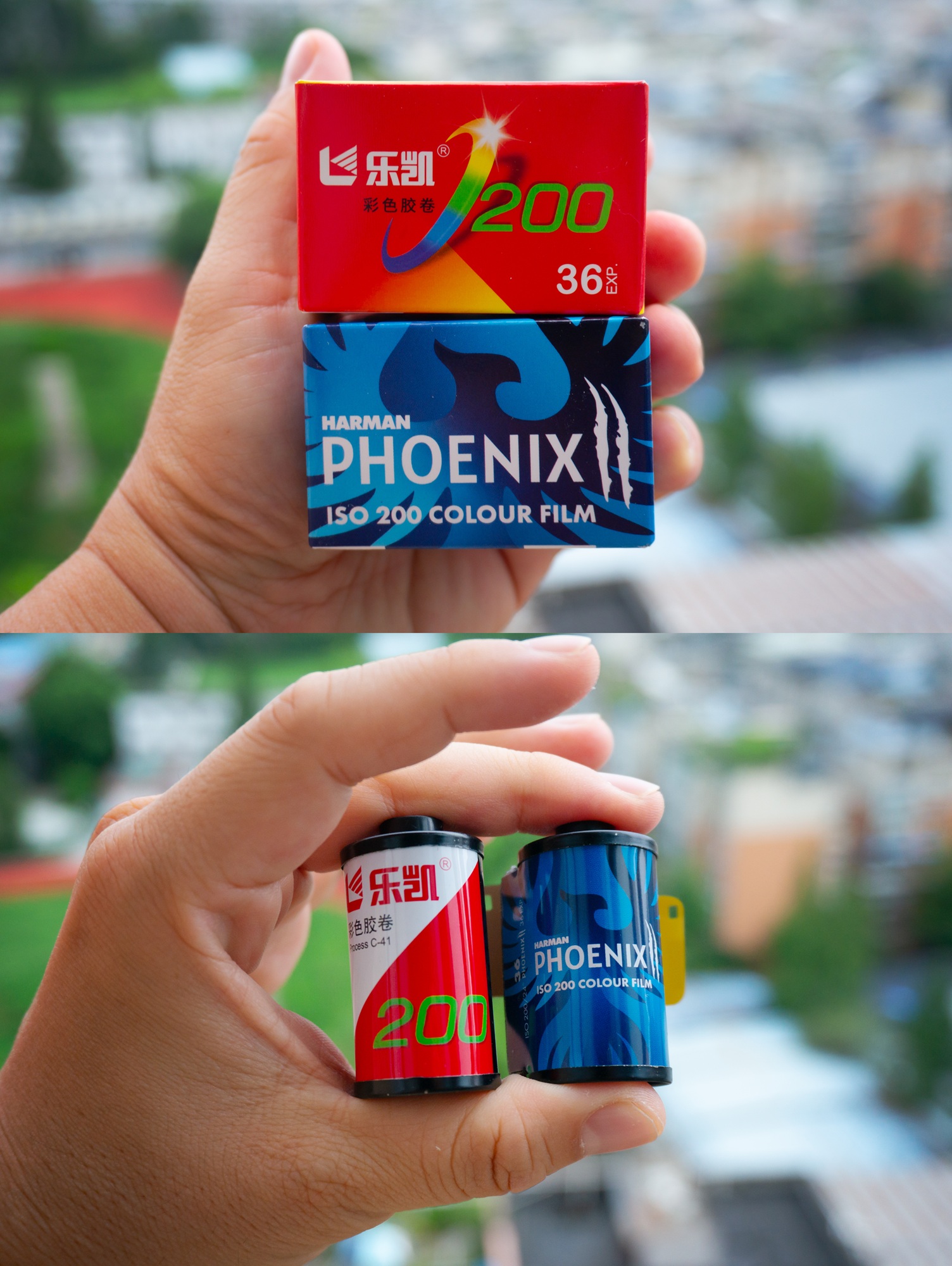

Despite being talked about a lot, there has not been much review about Lucky's new color negative C200 in the western part of the world since its lauch in July in China. I recently got my hands on this film and did a quick test comparing it with Phoenix II, which launched just one day earlier. Current price of Lucky is ¥59 (around US$8.2) inclusive of development/scan and 6inch print out.
Here are the side by side test shots. Camera is Contax G1+G45. I shot both films at EI 100. I developed myself in standard C41, and scanned with my R6, NLP converted using default settings.

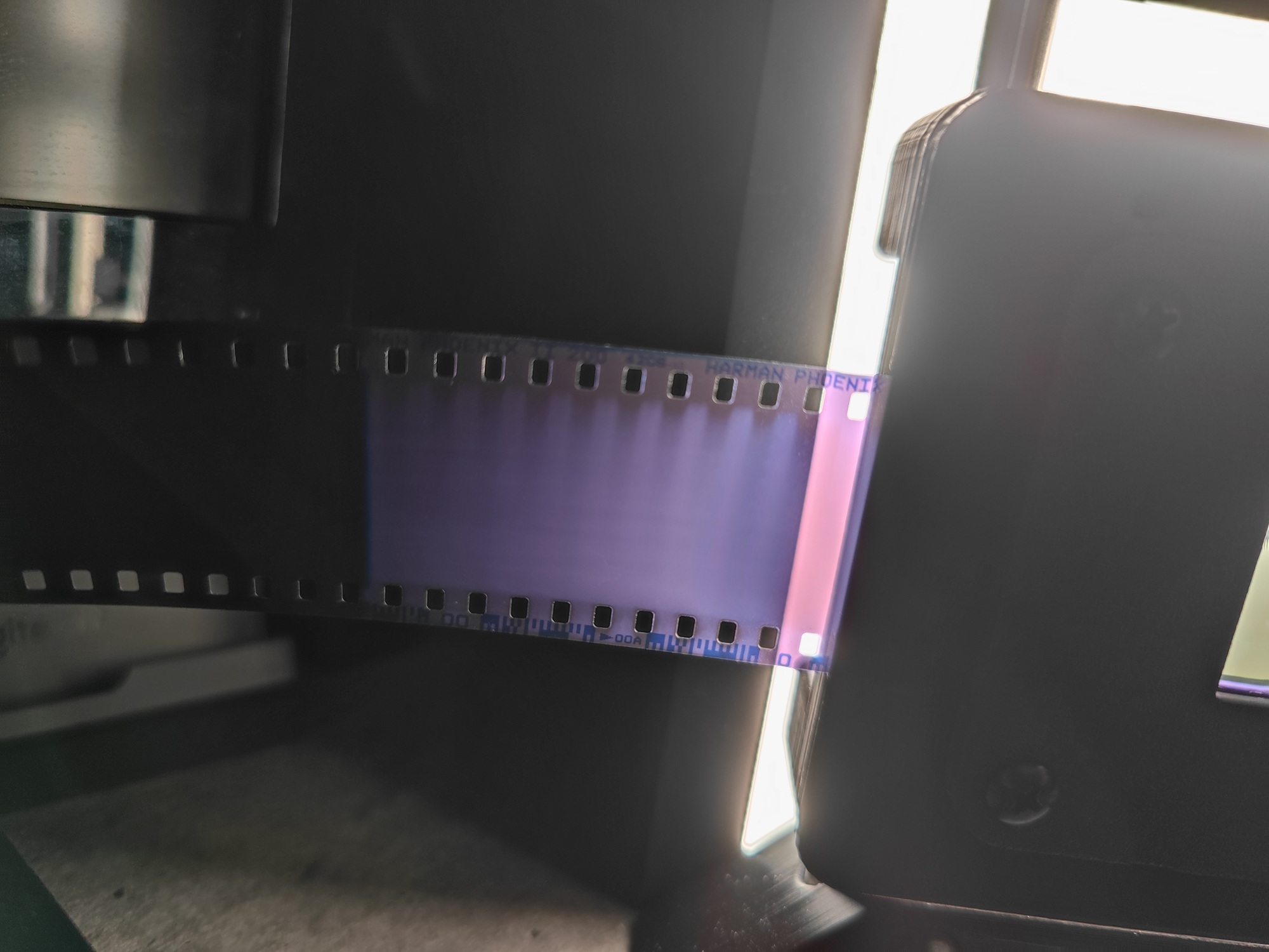

Btw, I encountered some banding issues with the Phoenix II. Has anyone else had this problem?

The banding in Phoenix II is definitely not a coating problem. I'd definitely check you camera and processing.

This looks like incomplete fixing. Check your processing.
