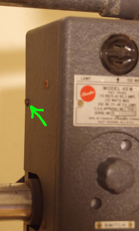

I figured out the answer to my own question after some tinkering. Here's how to oil the front bearing. First, you must remove the three screws shown below that secure the cover.
After removing these screws, the cover can be removed by pulling it toward you. It will hang down, supported by the three wires going to the motor. Then you'll see this:
The upper green arrow points to the inlet of the motor's front oil-tube. Drop a few drops of oil in it. I used conventional automobile engine oil, 10W-30 or something similar.
The lower green arrow points to the small visible segment of shaft between the motor and pulley. I put a drop of oil on the shaft by the bearing to ensure that the front of the bearing is well oiled.
The motor runs considerably faster than before, so clearly there was too much friction. I encourage you to oil this motor in your enlarger.

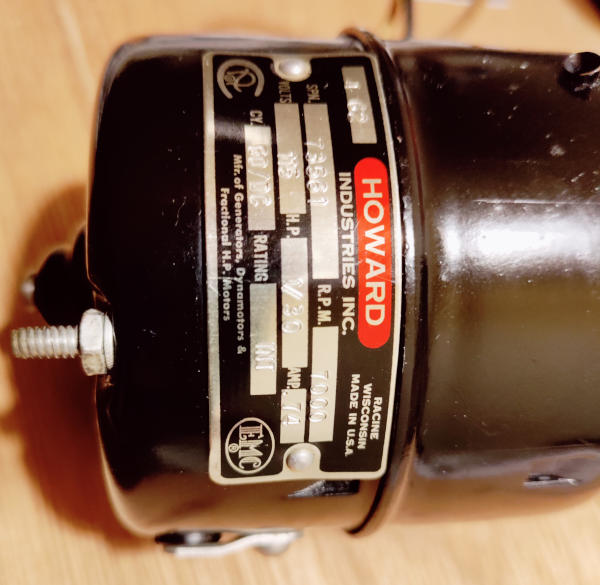

Even with engine motor oil, the motor still seemed to struggle some, so I took it apart and cleaned and relubed the bearings with Nye oil, which is a good lightweight oil. FWIW, here's the motor:
Based on this motor, does anyone care to guess what year it was made? After disassembly:
Note the metal removed from the rotor in two spots. Howard Industries took the expense of balancing their rotors. The brass/bronze bearings have felt oil-pads around them, making me suspect these bearings are not sintered. But I have too little experience with these to know for sure. I saturated both pads with Nye oil.
To my disappointment, the stator coil-assembly has no key to position it correctly, and the holes in it are not for the long screws you see in the photo. I aligned the stator by carefully matching tiny marks left over from manufacturing. Thinking about how these things work, I believe accurate alignment is not critical, but I still think an alignment key/pin/tab would be helpful.
