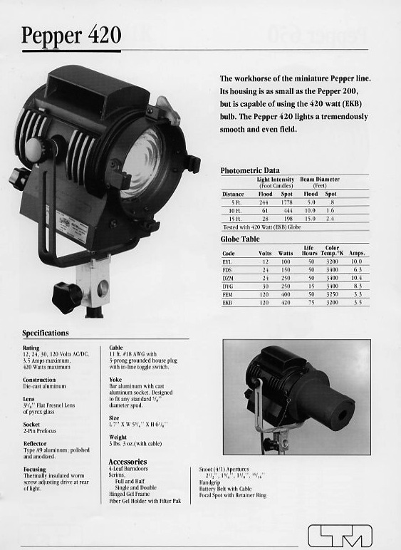

Steve, I have somewhere in my storage LTM peppers catalogue. Personally I went for Pepper 100 and using it with 100, 150 and 200W bulbs.

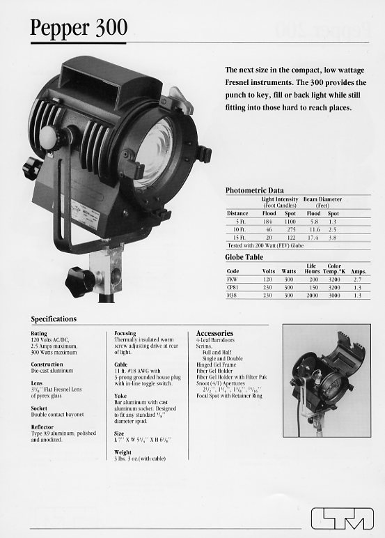

Here we go:
Sorry, in my previous post it should be 300/650W not 600W

Thank you for the catalog pages. It looks like the only difference between the two might be the lamp socket. One say "double contact bayonet" and the other is "2-pin prefocus".

You are right Steve, only difference is in the bulb sockets. "double contact bayonet" bulbs for 120V are ESR-100W, ETC-150W, FEV-200W, ESS-250W (a little to big & strong for pepper 100).
"2-pin prefocus" was very popular bulb socket for Lowell Omni and similar open faced instruments. It has one thicker and one skinny bulb leg. Typical bulbs are: BHC/DYS/DYV-120/650W;
FTK - 120/500W; EKB-120/420W.
Your catalogue is on the way!
