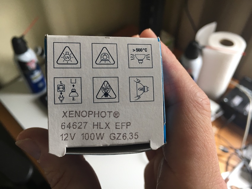

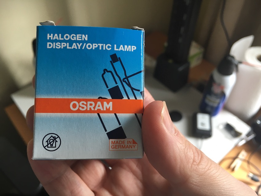

The bulb is this one (but the Philips bulb you link to will also work. In the UK they are about £6.50 each):
40+40, as you have discovered gives effective neutral density, prolonged exposure times and middle contrast as expected.
The one above from Osram is exactly what I have. Another pointer is that I noticed the new lamp seems colder in tone (and of course brighter) than an old one, I wonder if it effects the "grade" of light output through the mixer.
There is a thread about this subject that concerns the use of LED enlarger lights with the variation in warm tones like 2700k to cold tones of 6700k. I think I read somewhere that the Osram globe (I just eBayed one) is 3500k. This probably drops away with age.
