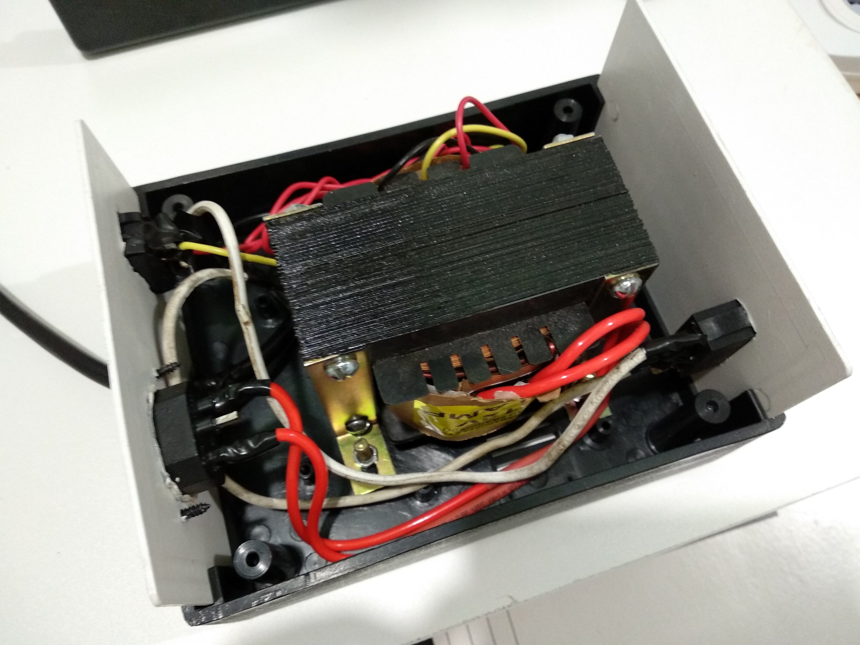

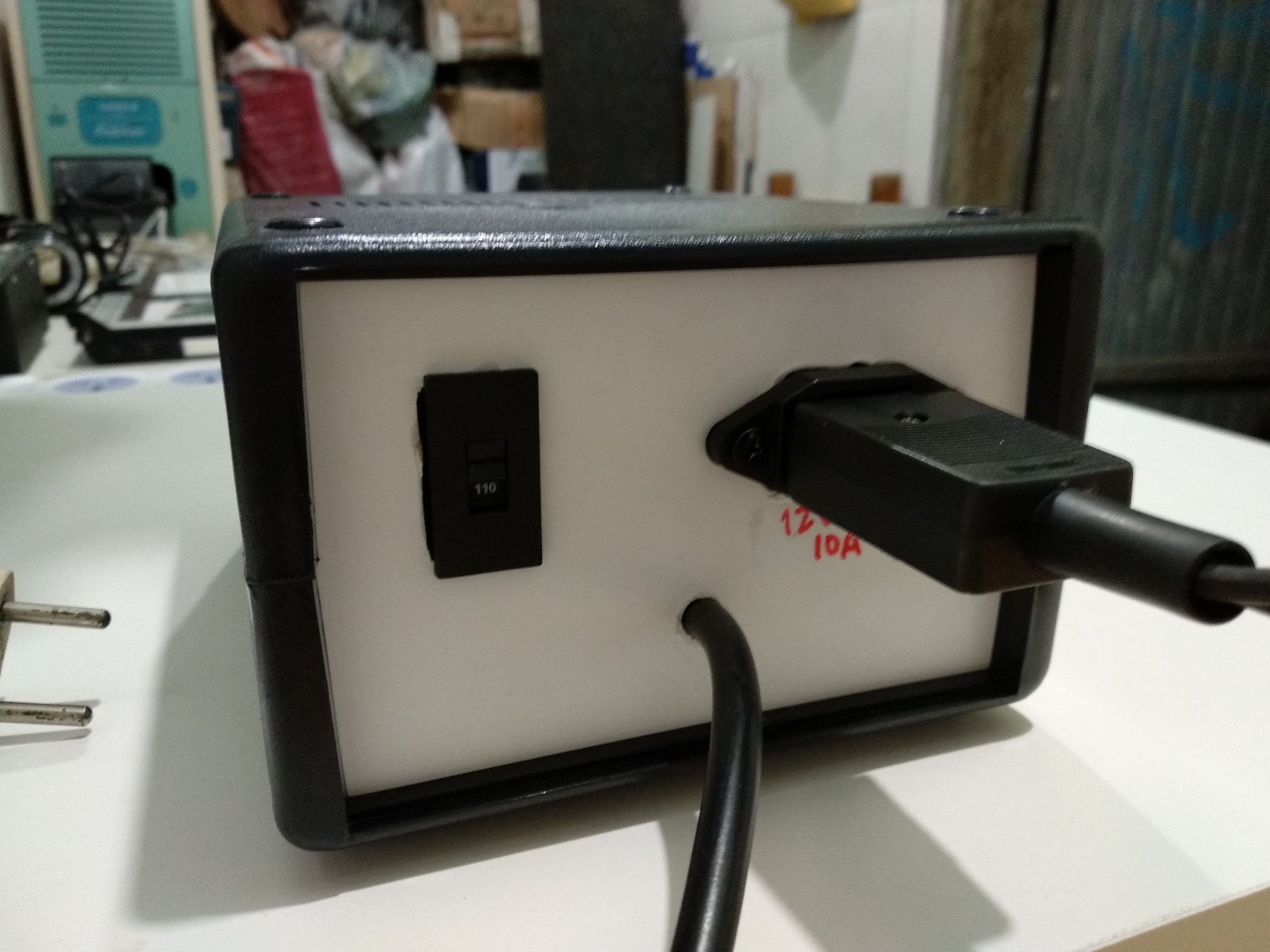

Hello everyone, this is my first post here, always find great references in this forum in my Google searches.
I bought an LPL C7700 Enlarger that is in good general condition but missing the 12v power supply and correct bulb.
The device arrived with a 250W lamp connected directly to the electrical mains (127v). Which serves for some quick tests, but not for use since it generates too much heat, and can cause damage to the mixing box or filters.
I was able (with some difficulty) to find a 12V 10amp transformer and built a box with selector on/off that should work but my doubt is whether the original power supply has other components besides the voltage transformer.
I tried Google images but couldn't find any reference.
100w 12v lamp is on its way...
Has anyone here ever opened or had to make any repairs to confirm this information?
Thank you!

I don't know to be honest, but I sure hope that your diy setup (which will work fine I'm sure) does have a fuse in there somewhere. It looks like you hooked up the primary of the transformer directly to the power socket, but it should be fused for obvious reasons.
If I were to diy a power supply for this application I'd use 12vdc (from a transformer, rectified and with a fairly large capacitor or a off the shelf smps unit) and put in some sort of voltage regulator to keep the voltage at exactly 12v. This will prevent any contrast or color issues in case you have voltage fluctuations (which is more a question of how big they are than if there are any).

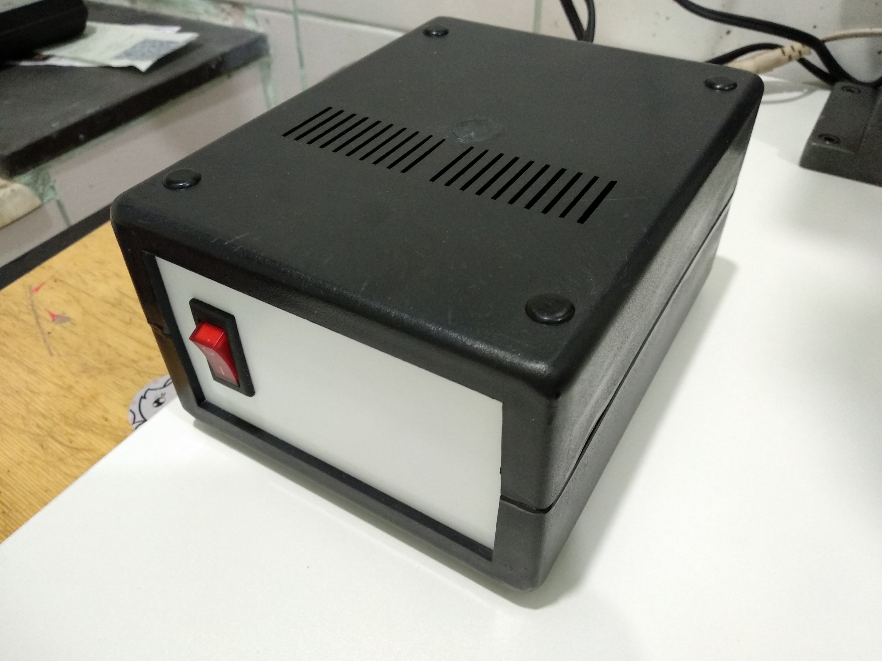

By the way I added the fuse, now just waiting on the bulb...

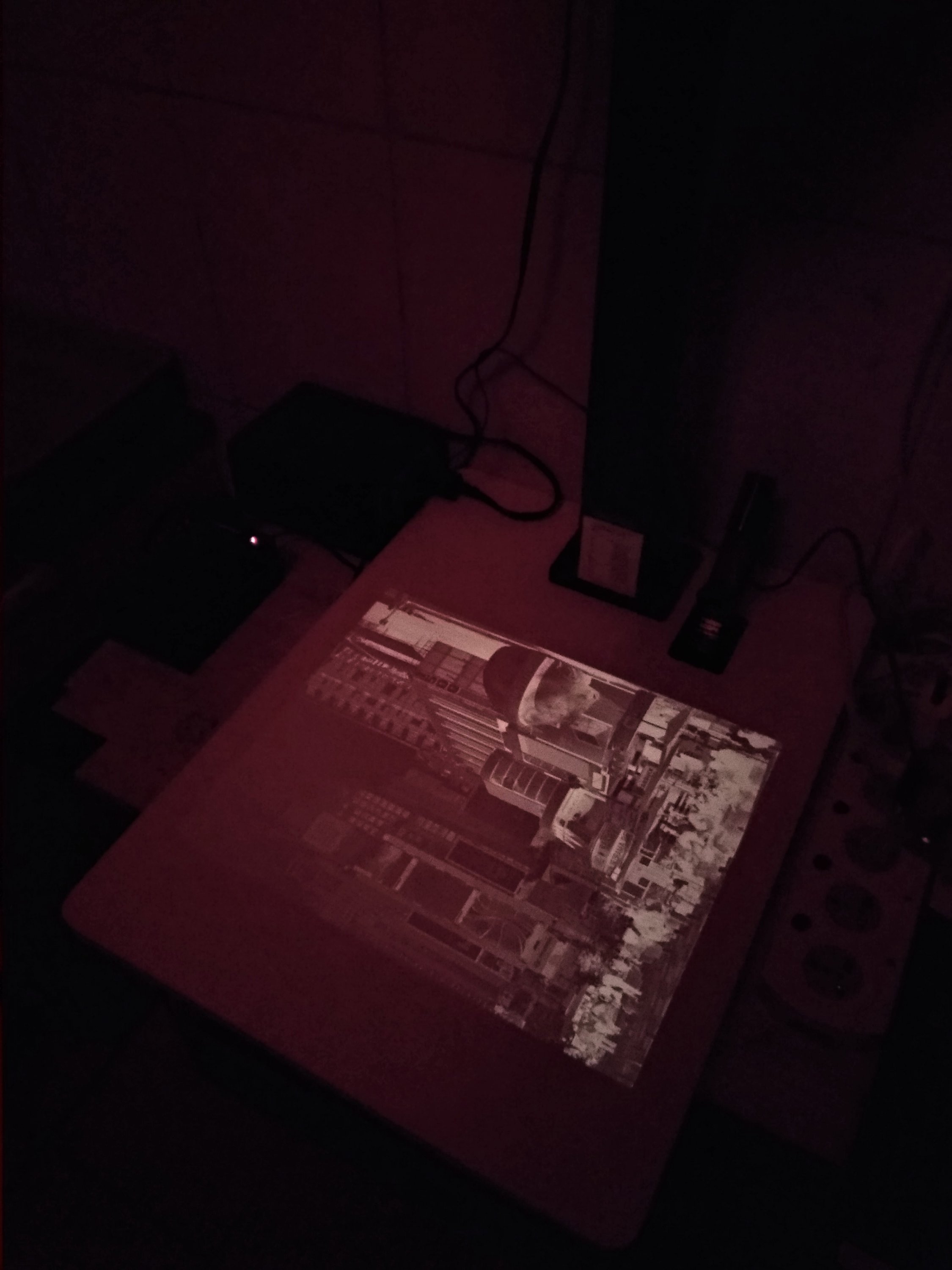

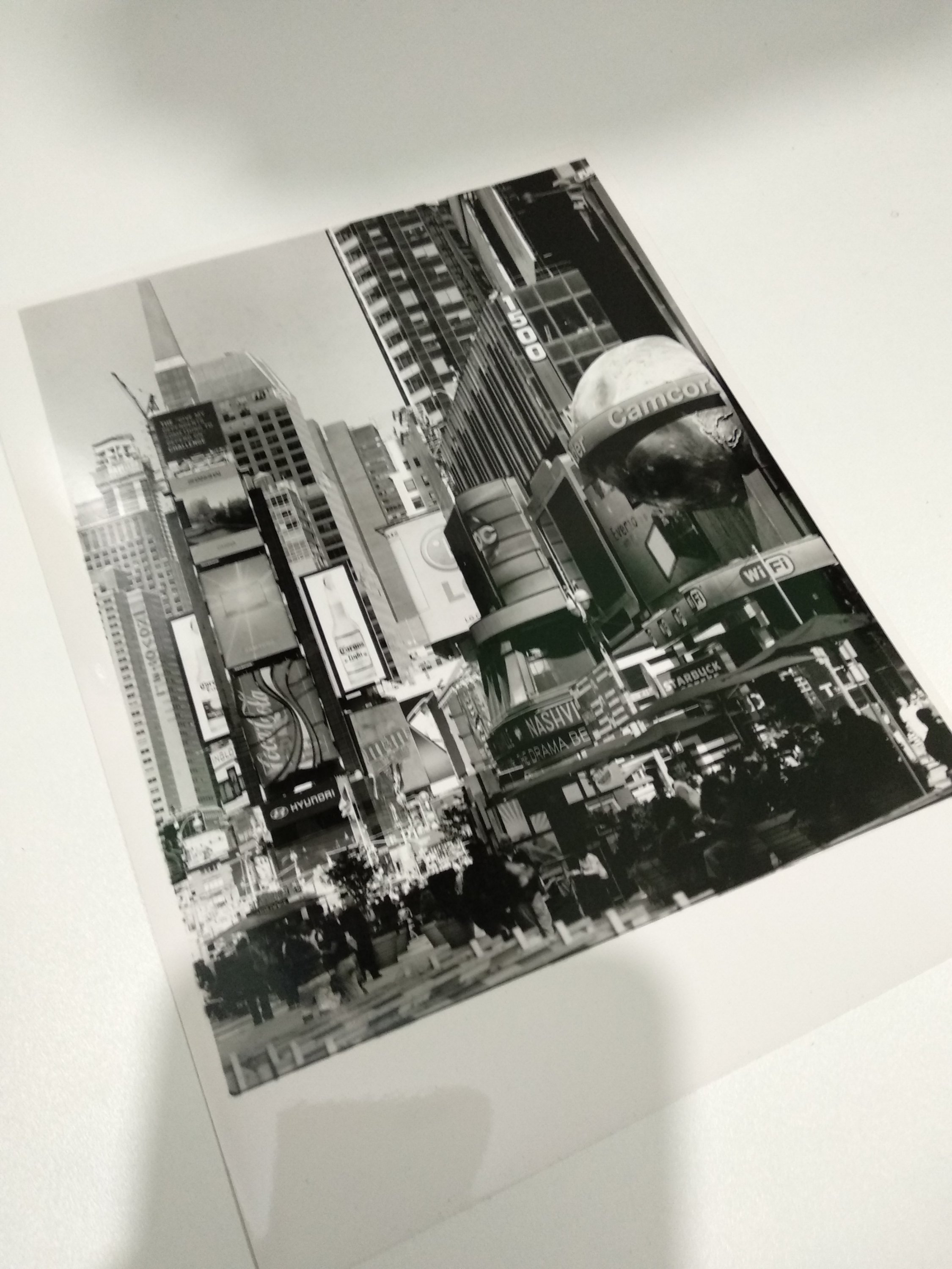

The bulb (Osram 64627 Hlx Efp 12v 100w) arrived today end fortunately the enlarger is now working fine and I was able to make my first prints :D

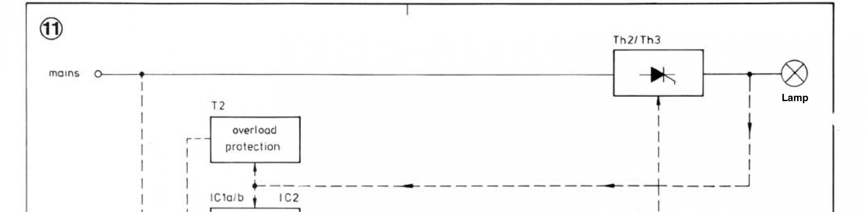

Yeah, because it's easier and cheaper to do regulation on DC. If I were to design a power source for an incandescent enlarger light source, a stable voltage would be one of my requirements to prevent shifts in the spectrum and output of the bulb, as color temperature tends to drop quite steeply as you lower the voltage on the bulb. It's kind of a chore to do that on the AC side but very easy on DC. A simple voltage regulator and a pass transistor for the heavy lifting does the job.
Many stabilized enlarger power supplies use pulse width modulation of the incomming AC via thyristors or triacs. Not sure how a conversion to DC is going to be more elegant than that.
