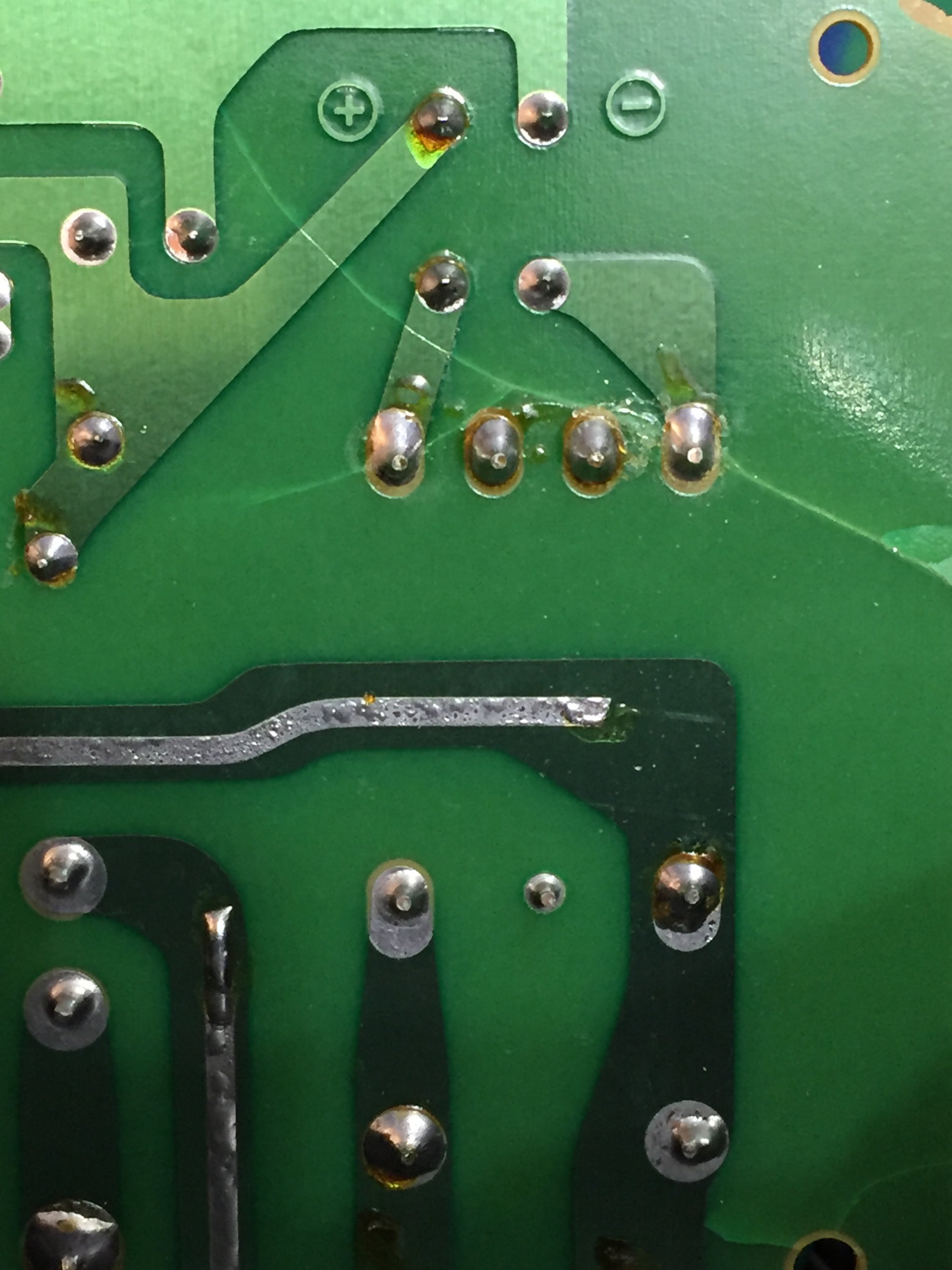

Would dropping some solder across the crack in the PCB between the solder points sticking out be a possible solution?
I am assuming that the reason the timer does not power up is due to the crack in the PCB.
Thanks as always for your input
Todd
I woud not trust Solder alone to reliably repair such a crack.
  1. Scrape away the green varnish (the solder mask) on top the broken tracks (two of them as far as I can see) for approx 10mm either side of the crack.
  2. Bridge the break with a piece of bare copper wire, soldered on either side on the bare copper track
Or, easier.
  1. From each crack, locate in either direction to the first solder bump.
  2. Prepare piece of wire of adequate length, strip the insulator approx 3mm each end, solder it on each of these two bumps.
If it were me, I'd try to use one wire from a telephone cable (those that run in the walls). In the US I don't know, but here they are single-strand fairly thin, easier to make a clean solder connection than with multi-strand wire.
And, if you never made a solder before: first melt a little solder on the iron's bit, then use indirect melting, i.e. iron heats wire, solder melts in contact with wire; finally, melt the bump on the PCB while pressing wire in place. Try to get some real solder (lead-tin); lead-free solder is a PITA. That alone will not make you ill from lead poisoning.

I agree with the advice given above, don't mess with trying to "mend" the break, instead add a piece of wire to join the opposite sides at existing solder points. Tinned wire (shiny silver color) is a lot easier to solder than bare copper (pink) wire. Stranded wire is more flexible than unstranded, you want a piece of fine gauge (18 - 22awg) PVC insulated stranded tinned copper wire.
Yes, just bridge the respective soder points by wire.
However, missing so far is advice on the crack itself!
You do not want the crack to go further. Thus glue (e.g. hotmelt) a stabilizing plate of an insulating material to the pcb. In addition you could drill small holes at the very end of the cracks. These would hamper the crack going further on line.
I have bridged cracked circuit board with just solder by cleaning the trace at the crack to 1/4 inch either side on small narrow contact strips. The width of the contact strip determines whether to solder only or use wire. The width of the cracked strips shown suggest moderate current and therefore should be bridged with #18 or #20 solid core wire.
Thanks as always for your inputView attachment 222945
Todd

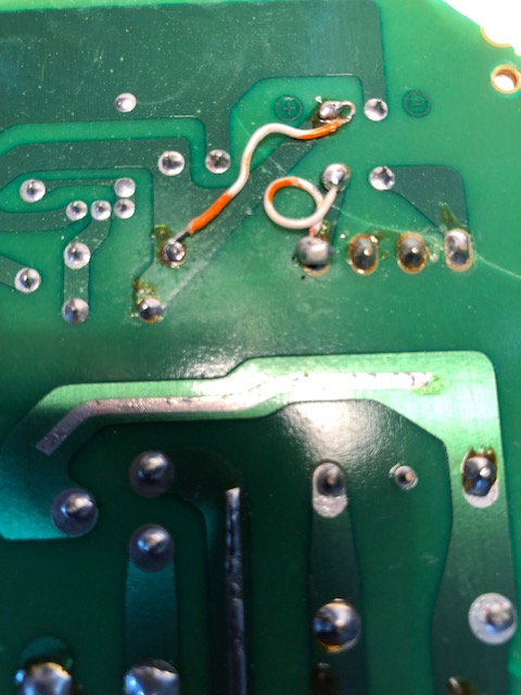

Success!
Thanks for all you help.
I went with the solid wire from telephone lines that are run within the walls (23 gauge 0.6mm diameter) when I traced the circuit it looks like the cracked portion was on the control side and not the power side the feeds the receptacles for the safelight and enlarger.
I have been testing it and no funny sounds, smells, smoke or flickering LED's.
Thanks again
Good! But I would ask myself why the crack happened in the first place, not just out of curiosity, but to prevent a repeat. I would second the advice given by AgX:
The timer came with some other equipment I picked up at a garage sale - it did not look abused but it must have been subjected to some rough treatment.
Now that I have it running I was going to mount the PCB on some rubber or foam washers to try and minimize direct shock transfer.
I like the idea of drilling the holes to stop the crack from continuing but there is limited open space on the other side (the relay covers a good portion of the crack), hot gluing a plate may be an option.
All the best
Todd
I think so far I have not yet come across a cracked pcb. But with that crack at a corner I can imagine the device having fallen on the same corner and that board being warped.
If a pcb has a heavy tranformer in its center and the device falls flat on, that transformer might induce a central crack.
Your board is based on plain paper layers. The better, more modern boards are based on woven textile and should be a bit stronger.
