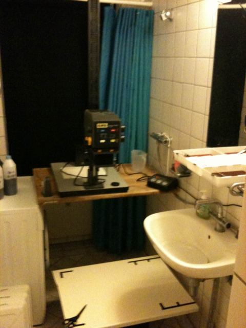

I have an LPL C7700 too, and I use it this way when making large prints. Lately I have been printing 20x20" from 6x6 negs.
As you can see I use my bathroom as darkroom :smile:
