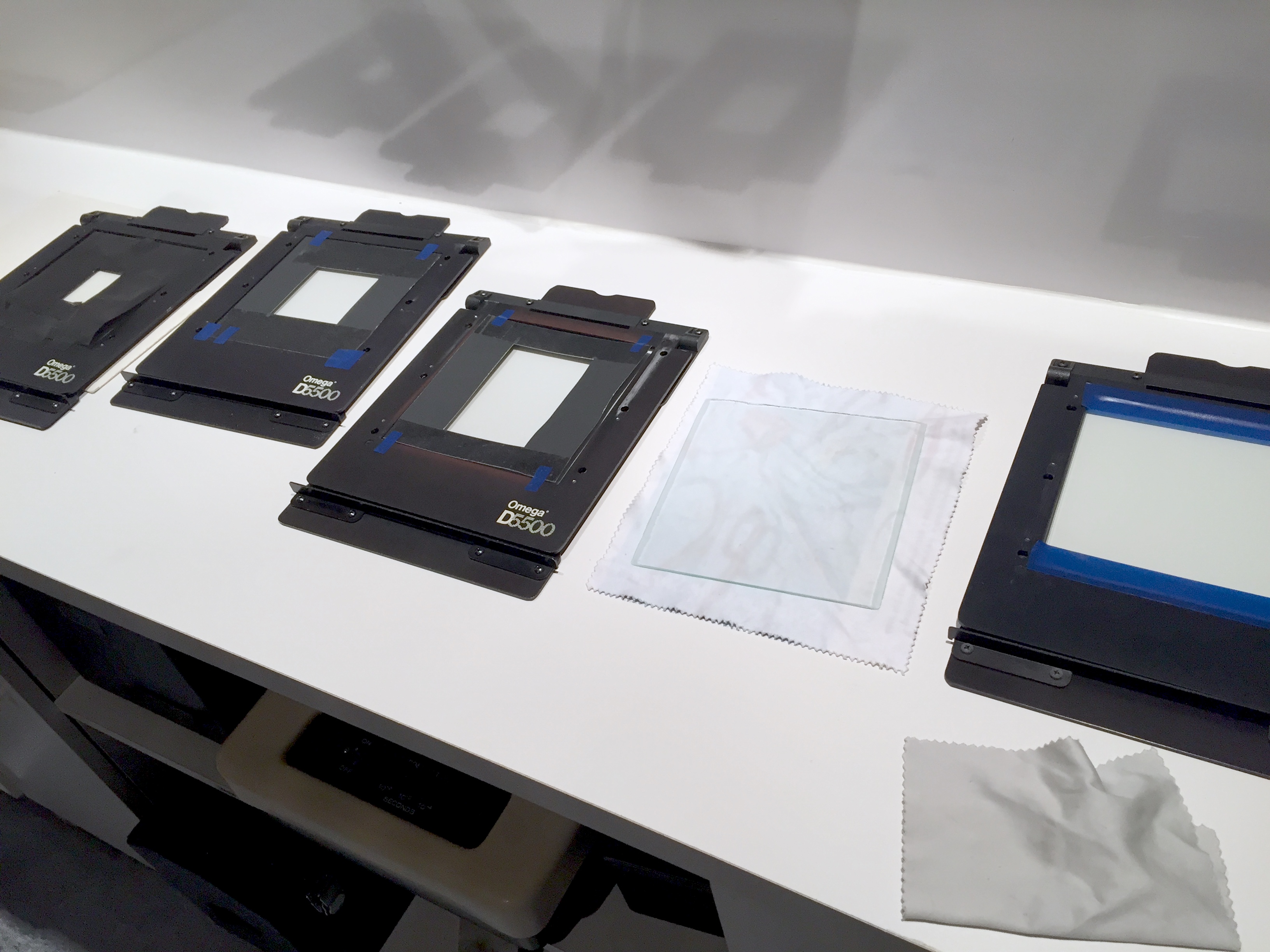

Glass carriers for the Omega D5500 are also very hard to come by, but over the years I found four of them. Just keep looking.
