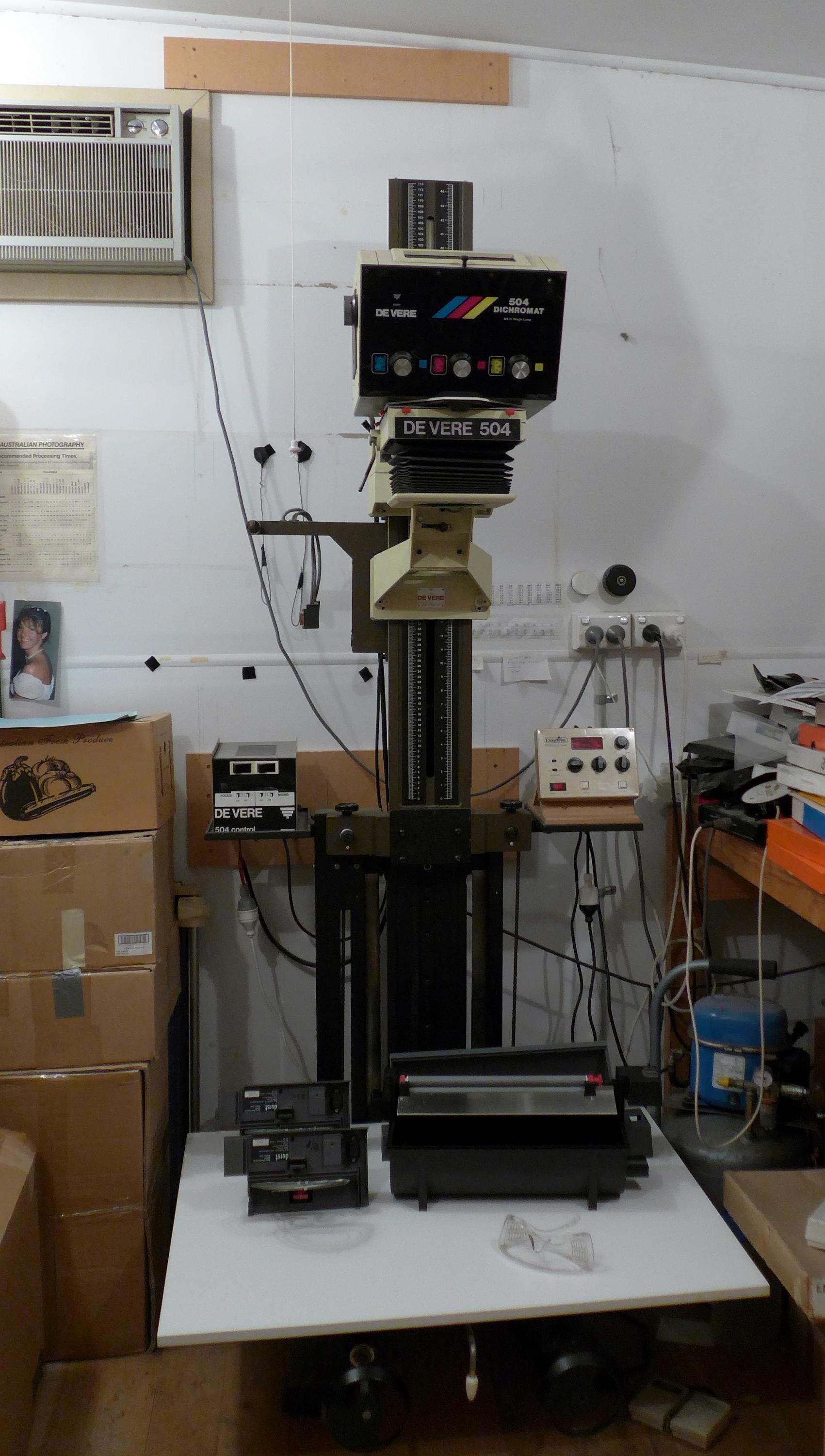

Hoffy, have a good look at the 7700 unit, right at the top of the enlarger column there is a bit you uncover and you will find a hole (going from memory here so could be a bit fuzzy).
That hole is where the wall mounting bracket secures the top of the column. The 7450 unit doesn’t have this hole in the top, but a 6mm to 8mm drill bit, or close to that size is used to drill a hole in the top.
Then you can use the 7450 enlarger on the wall. Unless of course it’s already been used and attached to the enlarger and hung on a wall.
May I suggest you ascertain the vertical on your proposed wall, I did on my wall and it was out a bit, so I attached a piece of MDF as long as the bracket system to two pieces of MDF on the wall, with one of the wall pieces of MDF adjusted out to ensure the wall column mounted brackets were at a true vertical, that is ninety degrees vertical fore and aft and left and right.
One only has to ensure your moveable table is dead level in both directions, you should be pretty sweet then.
Mick.

This particular enlarger had already been wall mounted, so there are fabricated top and bottom brackets.
As for how to do this, I am not 100% sure. The wall it will be mounted on is a typical plasterboard wall, but with a stud running right down the middle of it. I was actually thinking of getting a plank that will be secured to the wall (through the plaster board and into the stud) and then attaching the brackets to that. Then I know its secure, I can have the plank rest on the floor and then I can shim the brackets as required to get it exactly square and level!
I'll have a go at attaching a picture of my darkroom wall, where I mounted the wall mounts.
Basically I ran a couple of 17mm MDF boards across two studs, one at the top and a quite big one roughly 700mm from the floor. I then ran a vertical board, also 17mm MDF, to which the wall mount was attached. With this vertical piece of MDF I was able to get a fore and aft vertical, from there I then attached the wall mount and ensured it was left to right vertical. The result was a perfectly aligned enlarger.
I then made up a drop table that was just a smidge under a metre wide, with the main table normally being 800mm off the deck. This allowed me to have my legs under when sitting on my caster equipped office chair.
I dropped the drop table of the De Vere, so you could see the mounts. That drop table on the De Vere is 900mm wide by 700mm deep. I had a larger table, 1050mm by 800mm but that was too big, hence this is the original after being cut down.
I literally came in from the darkroom after a lengthy session and saw the notification on this thread, so I went back out and took this picture with the electronic thingy the missus has. The boxes are a couple of darkrooms of stuff that will be at the photographic flea market in Melbourne in a few weeks time, March the 15th in fact.
Mick.
