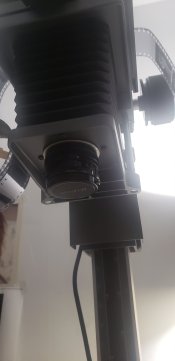

Hello!
I'm new to the forum.
I recently purchased an lpl6700 on Ebay hoping to start enlarging rather than scanning my work. There is a magic with an all analog process in my opinion.
Got the carrier, lenses, easel, loupe, gralab timer, whole 9. Power up and get a blurry image if attempting to enlarge at 8x10. Stop down and get sharper but too dark to see anything.
I bought replacement bulbs thinking that was the problem but no improvement. Am I missing something or did I buy a faulty head?
Appreciate you taking the time to read this.

No I don't actually. This lens plate is not recessed.

Could you post the link to the ebay ad you got it from? What is shown in the photo is not at all like any LPL I have owned. I have 2 6700s and the lens screws into a ring that is then mounted onto the bottom of the bellows by means of a thumb screw, maybe take a photo with the lens unscrewed to see what sort of mount plate you have.

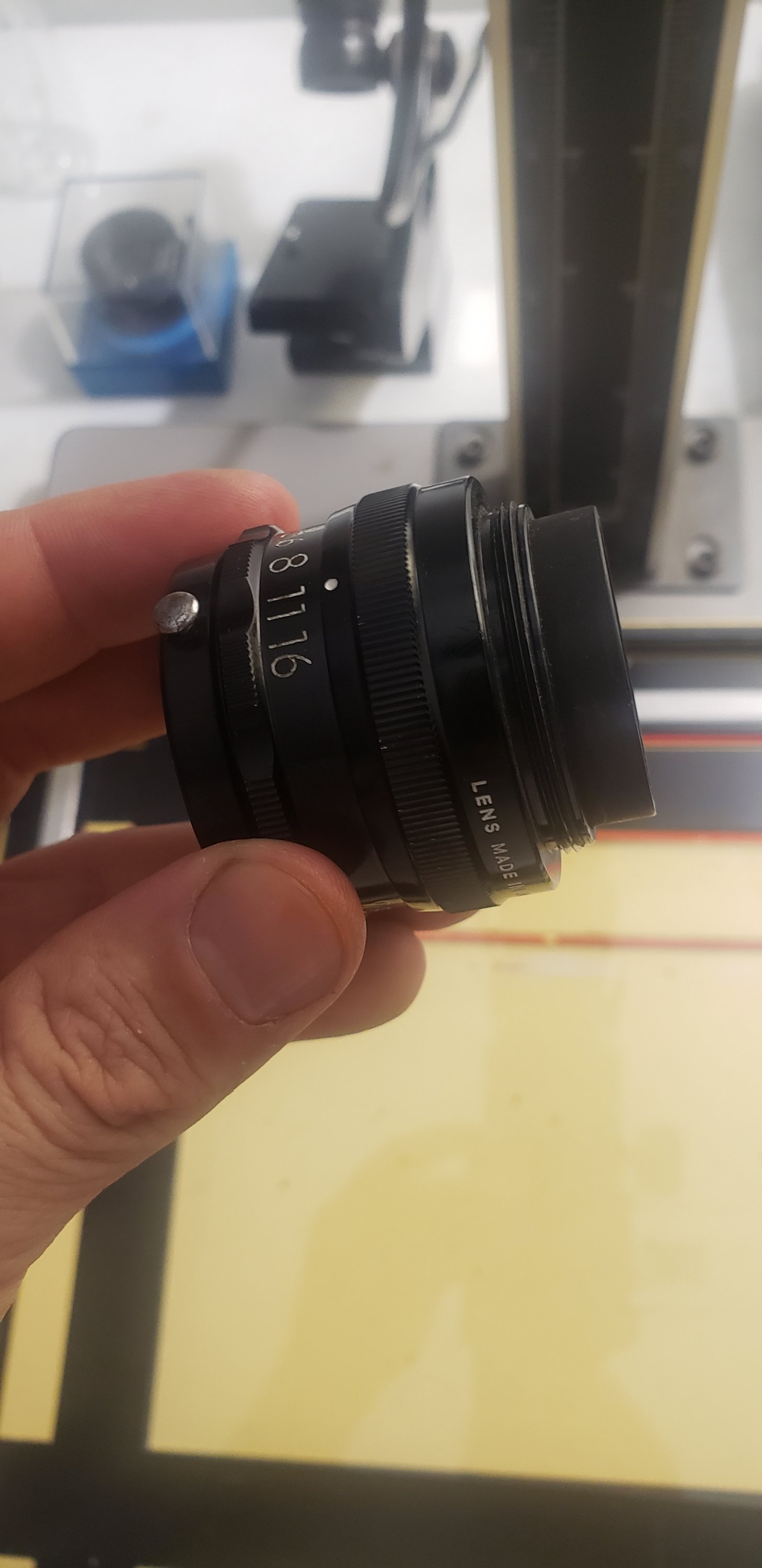

It looks like the enlarging lens might have an extension tube mounted on it. Take the lens off and see. Nikon offered a 15mm lens extension tube, needed for some purposes, but not for 8x10 enlargements with 50 or 80 mm lenses on this enlarger.

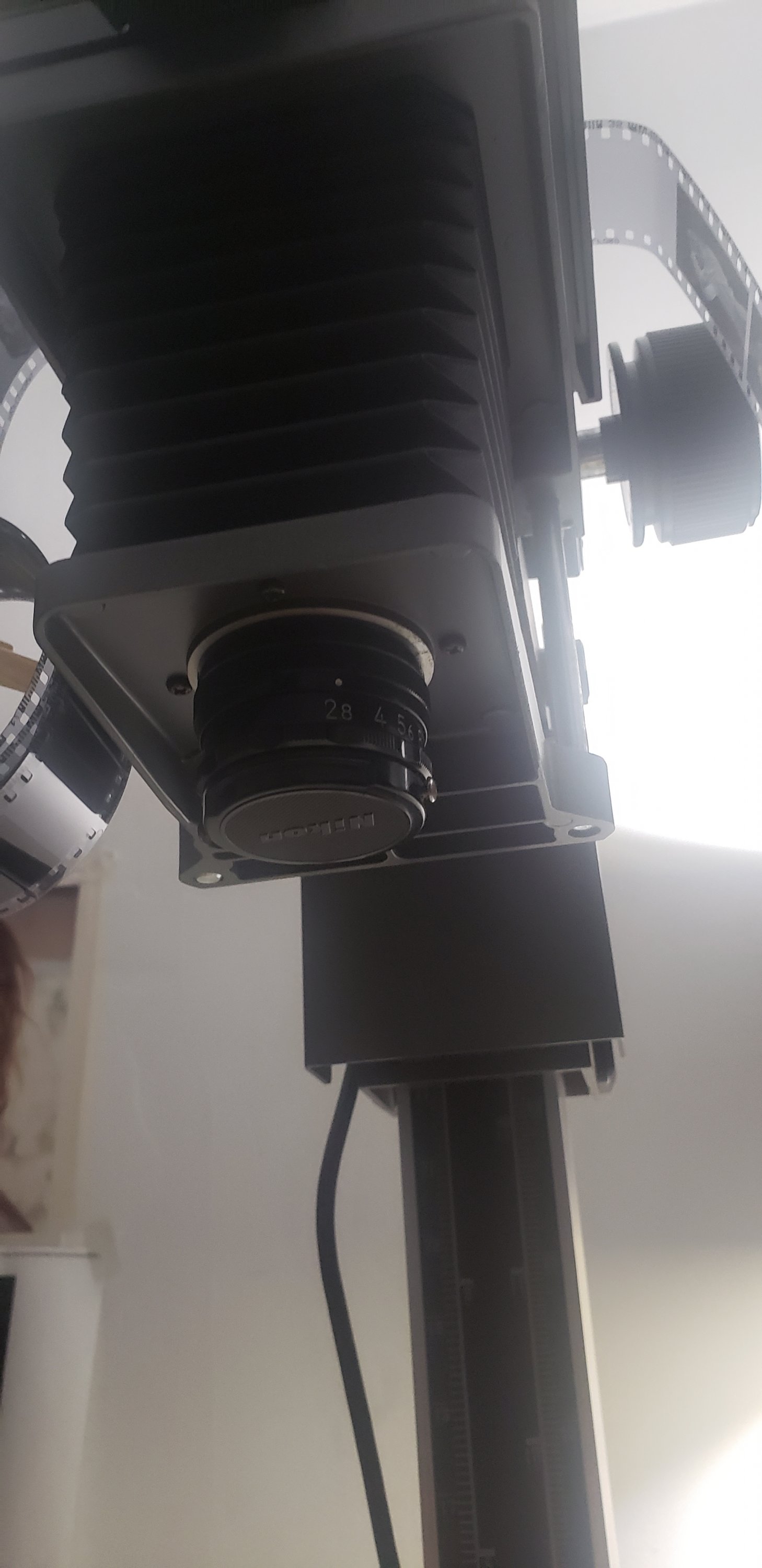

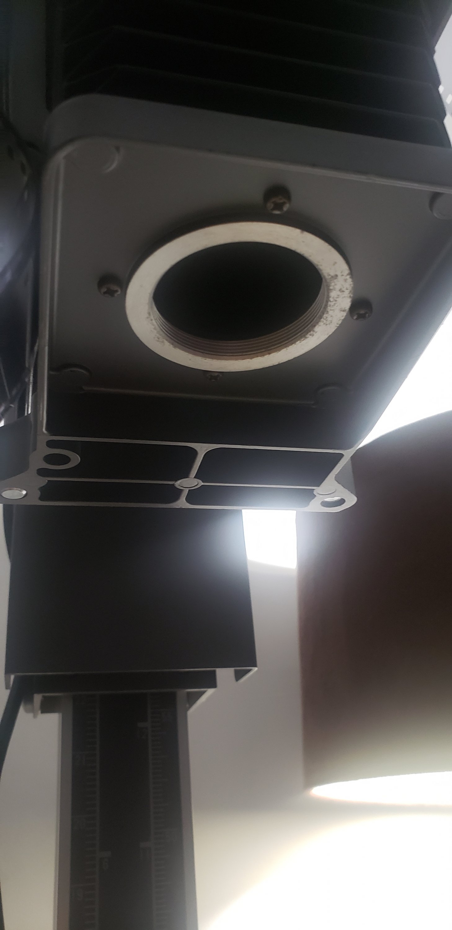

Maybe I need the extension ring for the plate?
Here are more pics

wow! you bought a head with no column or baseboard? You're brave.
In your photo of the enlarging lens, what is the focal length of that lens? And what size/format neg are you enlarging? I see another lens in a blue box in the background, what is the focal length of that lens?
Are the bellows in OK shape and do can you focus over what seems a normal range?

I just reentered the hyperlink. When clicking on the previous link, it pulled up a different head. Mine came with the column and baseboard. The lens is 50mm for 35mm negs. The blue is a 100mm componon for 120. No light leaks in the bellows. Speaking of focus, can I toggle the range somehow? It has a wide range when I rack, just not what I want to see tbh. The image gets perfect focus when I shoot the head all the way down the baseboard but gets grossly out of focus at 8x10

It appears the built-in 39mm threaded lensboard you have here is correct for this enlarger. The lens also appears standard, with no modifications I can see.
So, if you position the head halfway up the column, are you able to bring the image into focus on the baseboard at all using the focus knob? I assume you are aware that you need to refocus the image whenever you move the head up or down.

You nailed it! I changed the lens to the 100mm componon and poof, there was a sharp bright image with the head raised all the way up. I cant believe it could've been the lens. Doesnt seem to have any imperfections looking at it. Must be fogged up. I'll use the 100mm for now until I find a good 50mm, maybe get an APO this time.

You can try using the lens as a magnifier to test it on a very basic level. A dropped lens can have move an element out of position and cause problems.
