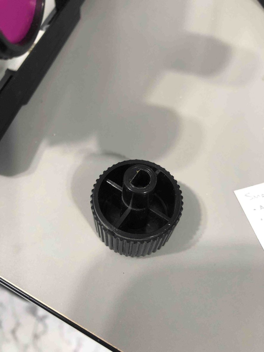

Knobs pull off.

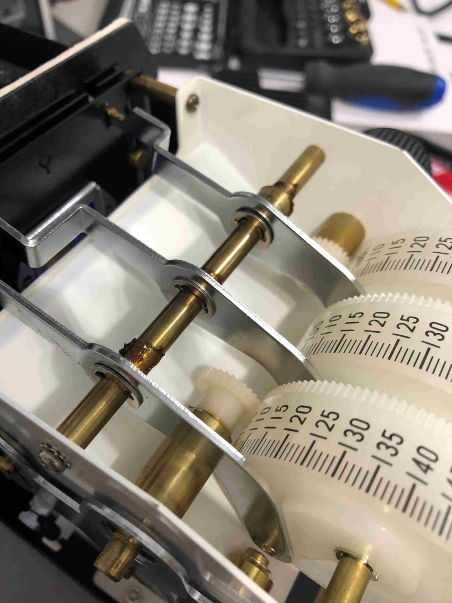

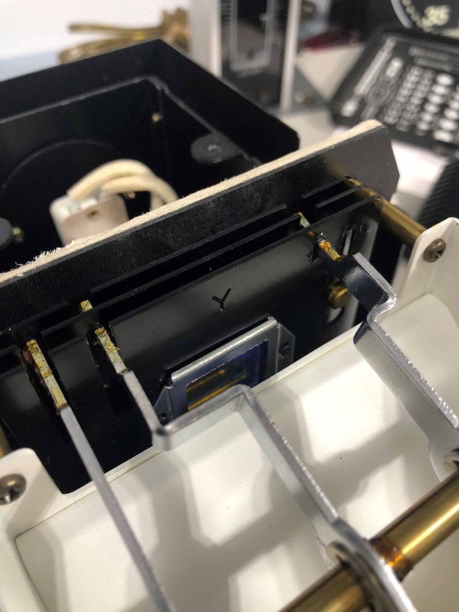

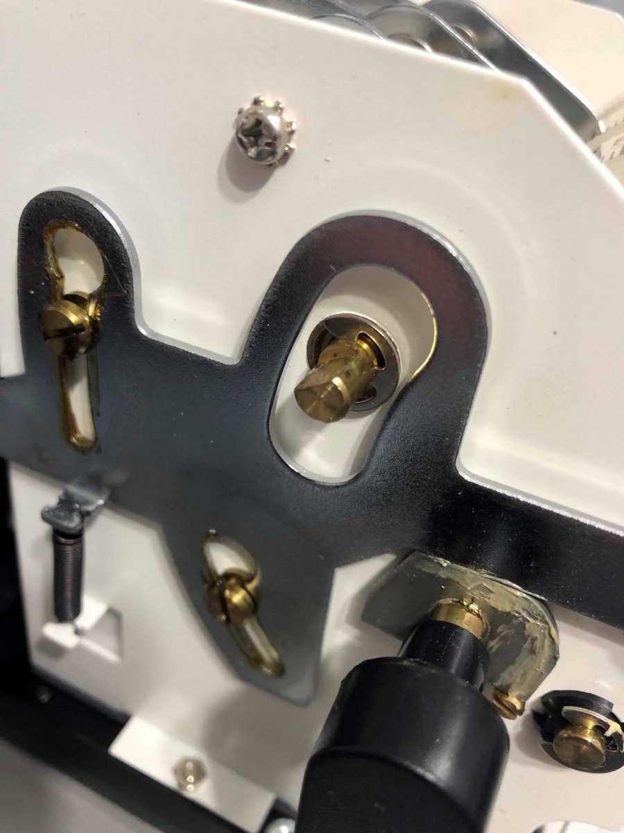

Knob.jpgShaft End.jpgSetting Wheel and Lift Arm.jpgLift Arm and Filter Interface.jpg
koraks
Nov 29, 2018
26,846
Europe
There might be a spring that pulls on the filter holder and the cam pulls it into the other direction. So by adjusting the dial, you make the cam pull the filter holder against the tension of the spring, holding it in a specific place. The filter mechanism won't work for instance if the spring has become dislodged. This is the first thing I'd check; so dig a little deeper and verify if there are springs present, and if so, if it's correctly fitted on the yellow filter mechanism.

Thanks Koraks, I thought there was going to be mechanical issue like you have described, fortunately when I check all springs were present and accounted for and in place. The issue was the yellow filter "lifting arm" seemed to be stuck, but once I gently moved it by hand the dial mechanism was able to take over and it worked just like the magenta and blue filters.
