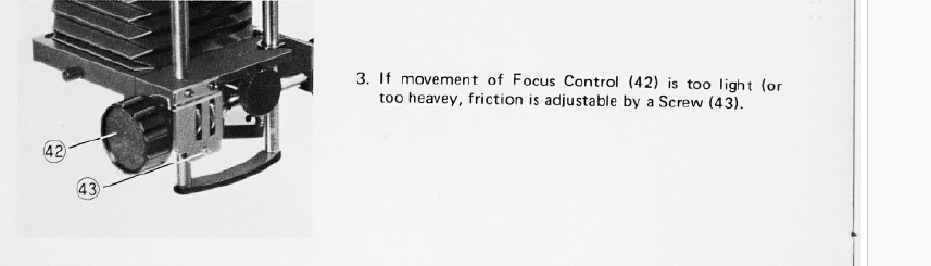

This is from the manual for a different LPL enlarger - the 7700 - but there may be something similar for yours:
