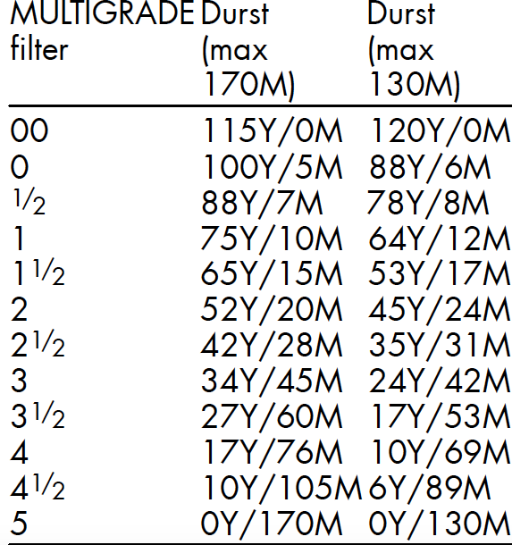

Sorry, to bring this old thread up again. But I am monitoring a darkroom with some Durst enlargers M601/605 and a CLS 66 head, as @afrank notice the CLS66 only goes up to 100. I like to know what the Y M settings are for the filter 00-5, just as for the Durst with 170M / 130M??
