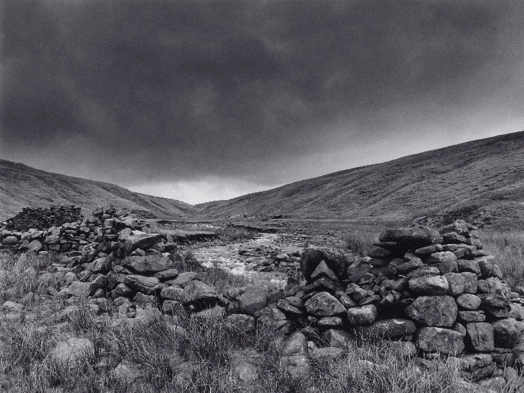

It's really a combination of exposure at the taking stage and adjusting the development of the negatives, plus a choice of subject matter.
Yes it is possible to change the mood of an image quite substantially by shifting the values, printing lighter and dropping the contrast or darker and increasing the contrast.
These are rather old, and poor quality scans, and the darker version has a bit more detail in the original but they should give you an idea.
Ian
