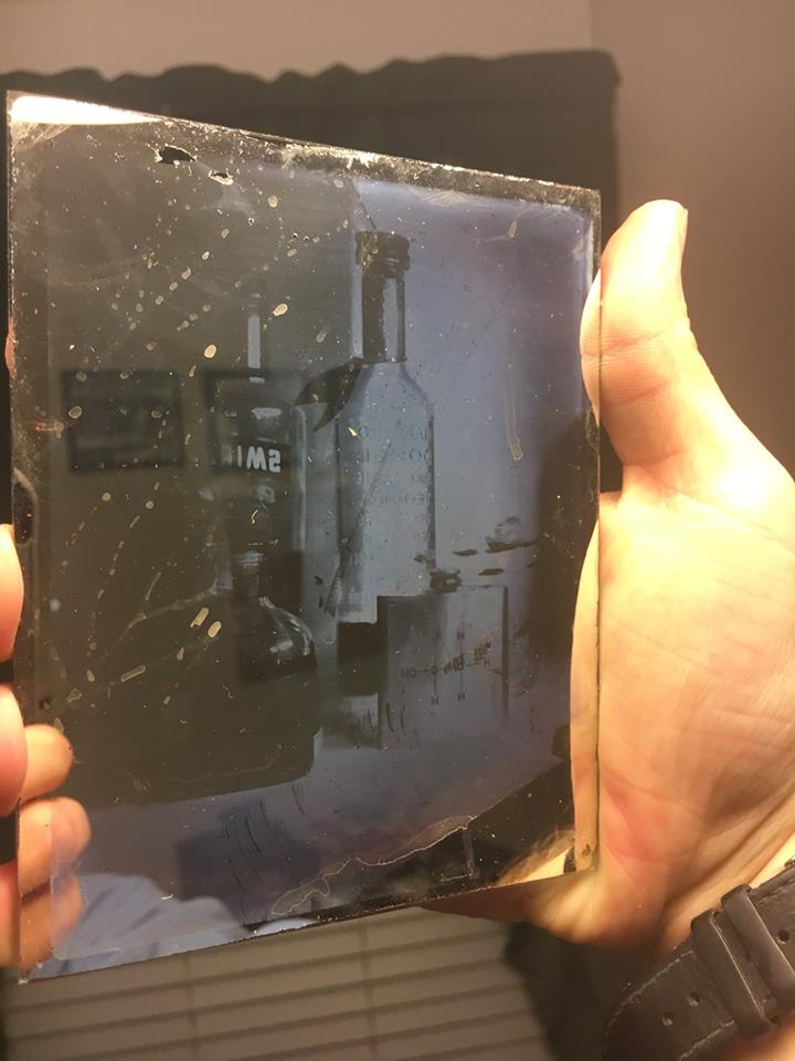

Hi everyone. I'm hoping a few of you will find this interesting. I wrote an instructional article at cdags.org about producing lower cost daguerreotypes. It focuses around two primary changes:
  1. Using the silver lining from common mirrors instead of the traditional copper plates, and
  2. using common povidone-iodine tincture to sensitize, rather than elemental iodine.
The guide uses the 'Becquerel' method of development (using the action of red rays) as well, so there is also no mercury involved!
You can find the guide here. Enjoy!

NedL - I think most of the fog comes from there being just not enough metallic silver left to reflect the light fully, with such a thin layer and all. You can go straight from sensitizing to fixing and that fog will be there. I do think there's some validity to your observation about rubylith -- I once accidentally set my timer wrong and developed a plate for a full 24 hours. Totally fogged! I know heat is also a becquerel daguerreotypist's enemy, but IIRC the plate was fairly cool. I think it's definitely worth exploring different colors and filters and observing the effects. Lately I've been playing with a yellow filter (3 layers of Rosco #15 Deep Straw) which has a much faster developing action - 15 - 30 minutes!
AgX - To be honest, I haven't really investigated much into the paint stripper. I don't think it's turpentine based, as Citri-strip is promoted as safe for indoor use. I'll try to look into it.

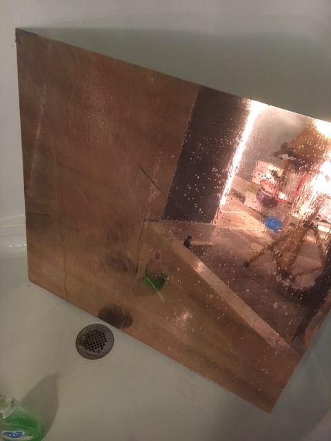

I managed to dig up an old snapshot of a mirror before much of the copper had been removed. I won't pretend that I know all that much about how mirrors are manufactured by any means, but this does look like a legitimate layer of copper.

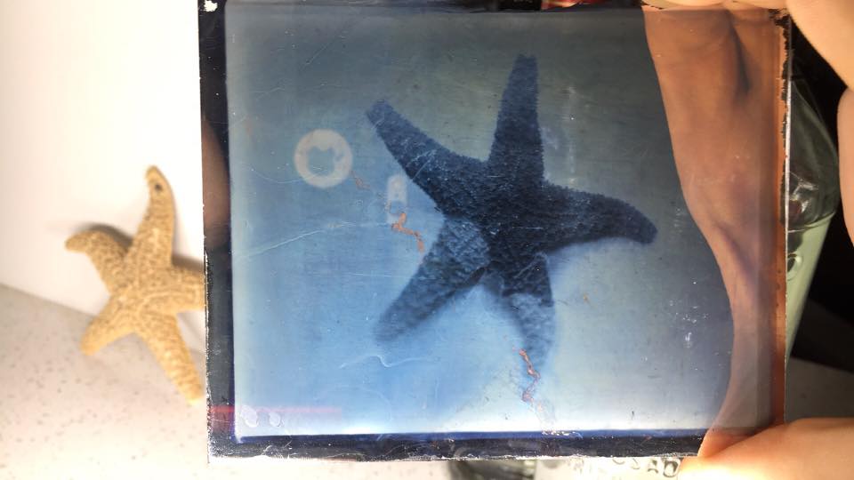

This is a very cool article / idea and I can't wait to try it (always had a thing for Daguerreotypes). Have you ever thought of making your own silver mirrors rather than stripping off the backing paint and worrying about aluminum mirrors or copper backing layers. A company called Angel Guilding (no affiliation. Probably others as well) sells the supplies to make Ag chemical deposition mirrors (used for sign making on glass). You can double coat (sometimes triple). More importantly they have a ton of videos on YouTube about making mirrors, removing backing paint, etc. There are other homebrew processes involving silver-nitrate or fired silver paste to make a mirror but I don't think the quality would be there. Likewise silver electroplating often involves silver cyanide which is dangerous. There is however true silver-leaf that's dozens of times thicker than a deposition mirror so water guilding silver onto glass might solve the shadow problem (don't know if the gelatin seize would interfere though). Anyhow, great work on making dags more practical.
I think I touched on this briefly in the writeup. But yes, my very first daguerreotypes were made using the Angel Guilding kit! It can definitely be done, but I had a few troubles with it. Firstly, the silver had very poor adhesion to the glass, particularly during fixing. The fixing solution had to be even weaker than it is now, and I could barely agitate the tray at all for fear that it would strip off large chunks of the image. I also had great difficulties getting a good surface mirror - often it would be chemically fogged, requiring gentle wiping before washing or the fog would be permanent. Due to the poor adhesion of the silver, the plates couldn't be polished in the traditional way either. I'm attaching some of my kit-silvered plates.
If you're interested in reading more about it, you can check out this paper here. I definitely picked up a few tips from that document.
I do plan on trying out the more traditional Tollens reagent method at some point, and not just for daguerreotypes either -- there is a method of creating flexible silver mirrors to replace mercury in the Lippmann process as well. May as well kill two birds with one stone!
Silver leaf would be really interesting to try as well! There was an old post on cdags.org where a user used silver leaf, though they never posted any pictures of the results. I remember that post well, because it's where I stole the idea of using iodine tincture! I might order some leaf for a bit of fun, just to see what happens.
