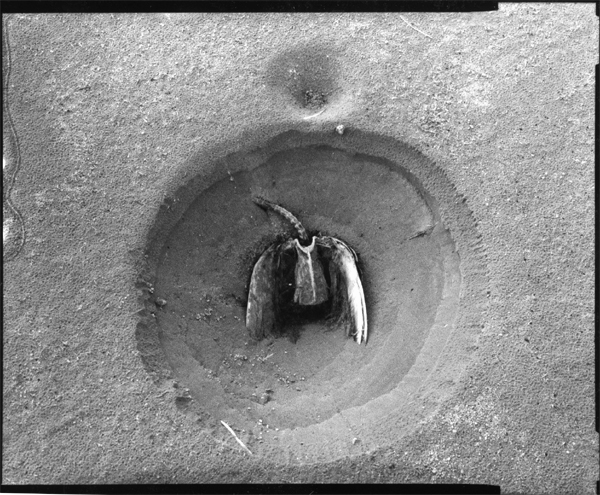

Tim,
It was alluded to a bit in the other thread, in regard to AA's examples, and I'm wondering if you also aren't expecting a lot from an un-manipulated print.
Here are scans of a straight print (I think it scanned a little hot), arrived at to establish the base exposure for this negative, and the print after dodging and burning.
