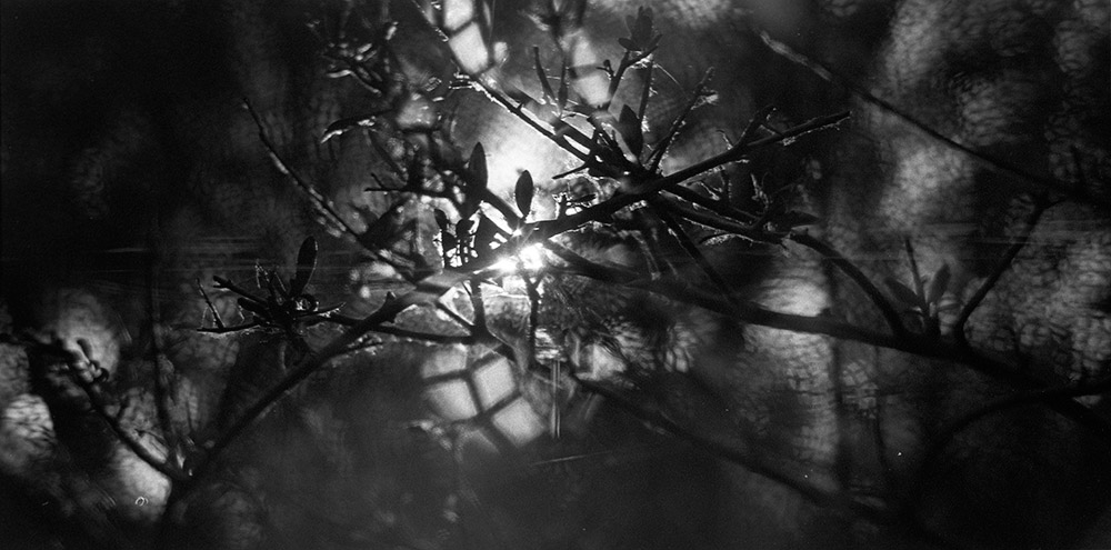

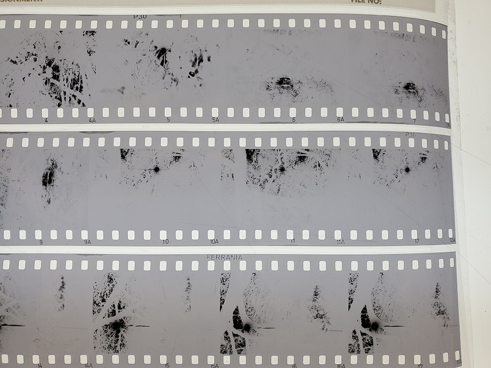

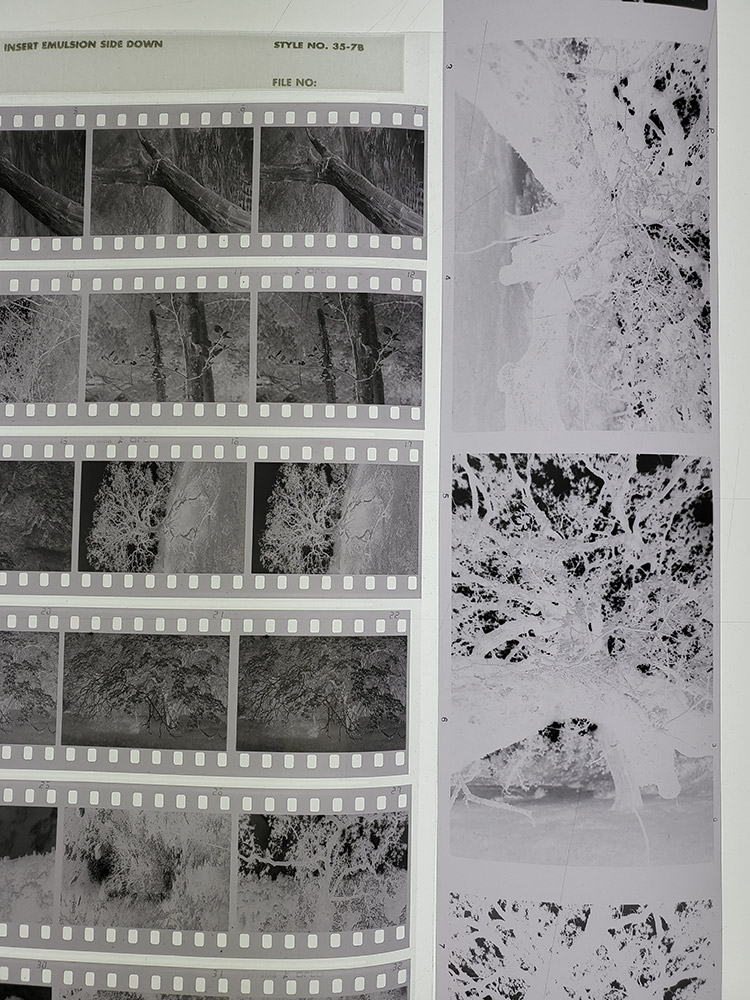

I'm looking for a low contrast developer that works well with P30. I recently shot a bunch of it and I developed all of my 35mm rolls in FA-1027. Half of my results look normal while the other half are too high contrast to be usable. With backlit trees in particular I'm getting a few highlights on a nearly blank frame. I still have a bunch of 120 film to develop.
I'm wondering if anyone has any suggestions for developers that can deal well with the contrast of P30? Some of the developers I have in mind are POTA, CD4-LC, and Barry Thorton's 2 bath. I've had really good results Barry Thorton's 2 bath and Orto 50. So far most of the developing times I've found for these are for film shot around ISO 25, and I shot everything at box speed.
Note that the main problem in those negatives is underexposure. You can throw a low-contrast developer at it, but in this case it would just have tempered the highlights, while most of the frame would have remained blank.

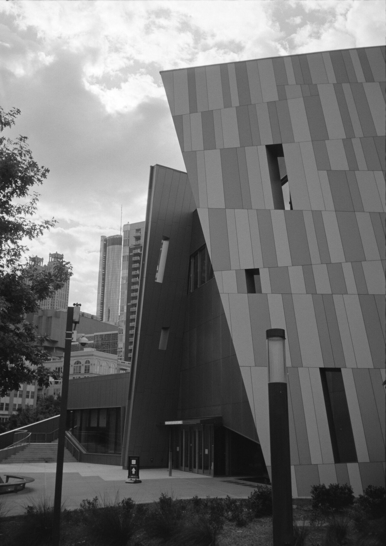

I posted one example which is alongside a few others from a walk across central London:

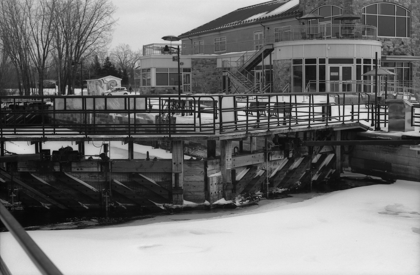

I'm not sure about exposure. I also shot some rolls of Adox CHS II here in the same scenario, and it came out fine. Here is an example.
