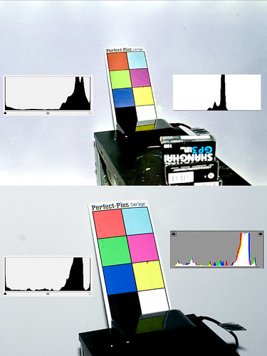

When I develop C-41 in Rodinal, and fix, bleach and re-develop in E-6 colour developer, bleach, fix, etc, only green-mask compensation is needed, using C-41 then gives orange mask negs as normal.
There is also the ability to dilute C-41 and process for longer, which has been explored lightly on flickr and gives varying results.
I've also been experimenting with making a highly dilutable (1+100) 20 degrees celsius colour negative developer, that works in stand and semi-stand for an hour at 1+100.
I've had varying degrees of sucess:
(top film, bottom digital reference)
Trying to get the right negative contrast at 20 c is something I'm still working on, in fact it needs a lot of work.
In short, its up to your own ingeniuity to come up with solutions to problems, instead of just accepting the status quo, if we all did that, humanity would never have made any progress.
And yes I probably should buy a full colour chart, but this does the job for what I need for the time being.
