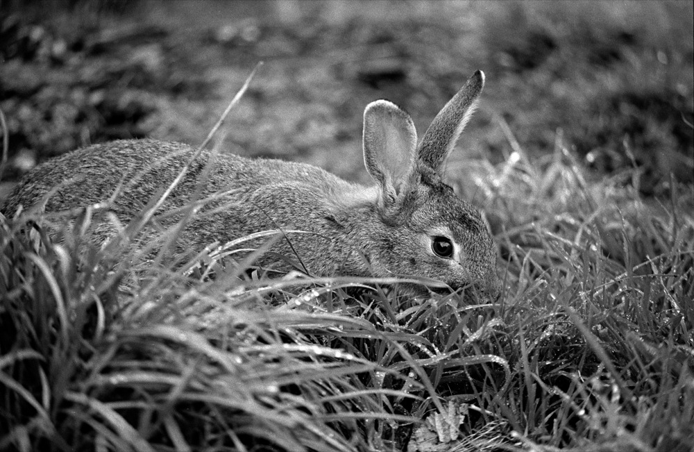

when processed as a negative myself:

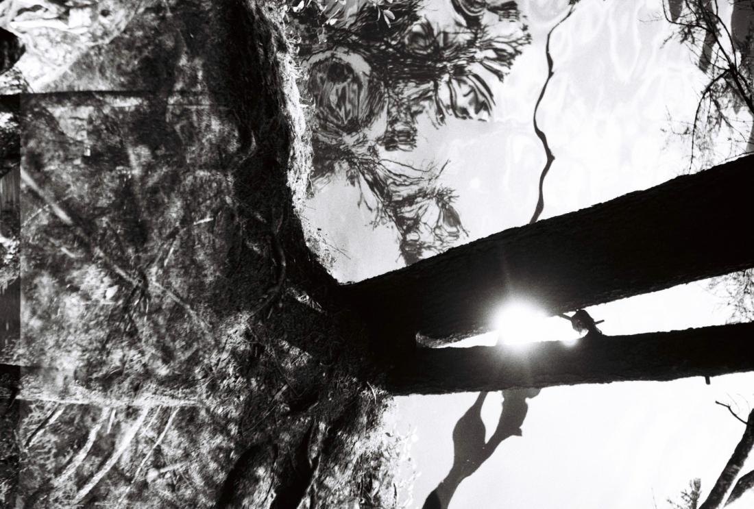

Or a positive through DR5:
Its an oft ignored great film. Done right it has classic tones, fine grain for a traditional 400 speed and very clear base. Its my favourite 400, esp in 35mm where its resolving power far exceeds TriX and HP5+. Useful if you dont want to give up too much detail but need the speed.
