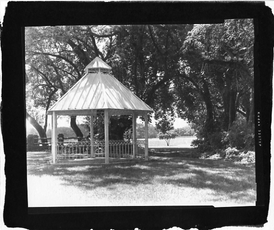

I develop my own film and received satisfactory results (even in the same lighting situations) in other frames. The issue is that these frames pop up out of no-where.
Thanks for the heads up on exposure. I'm pretty familiar with how to expose night time exposures properly but still learning a lot as I go. The issue with the first frame is not so much the exposure (I actually intended it to look that way) but the black splotches coming out from the bottom of the image. That's supposed to be just an even exposure.
While I suspect the third image is also my mistake (in terms of exposure), the issue for me is the black edges near the top and bottom.
Strangely enough, it's only certain frames that are affected, not parts of a roll. This leads me to believe it's not my developing as such.

Looking closely at your samples, they do seem to show uneven development which, as bruce suggests could be down to excessive agitation. One of the reasons I suggested you read up a bit on night photography is, there is such as thing as "reciprocity failure" with film when it comes to low light exposure....this is most commonly associated with colour film, but I find it applies also (albeit to a lesser extent) with black & white. Basically what it means is that you often have to give approx. double the exposure that your meter suggests when it comes to longish exposures.....depending upon the shutter speed in use. It takes experimentation to find the right amount of compensation..(which will also depend on the developing technique). So long as you bear in mind that auto-exposure systems in cameras are a compromise, and you always need to modify your exposures in unusual lighting situations.
