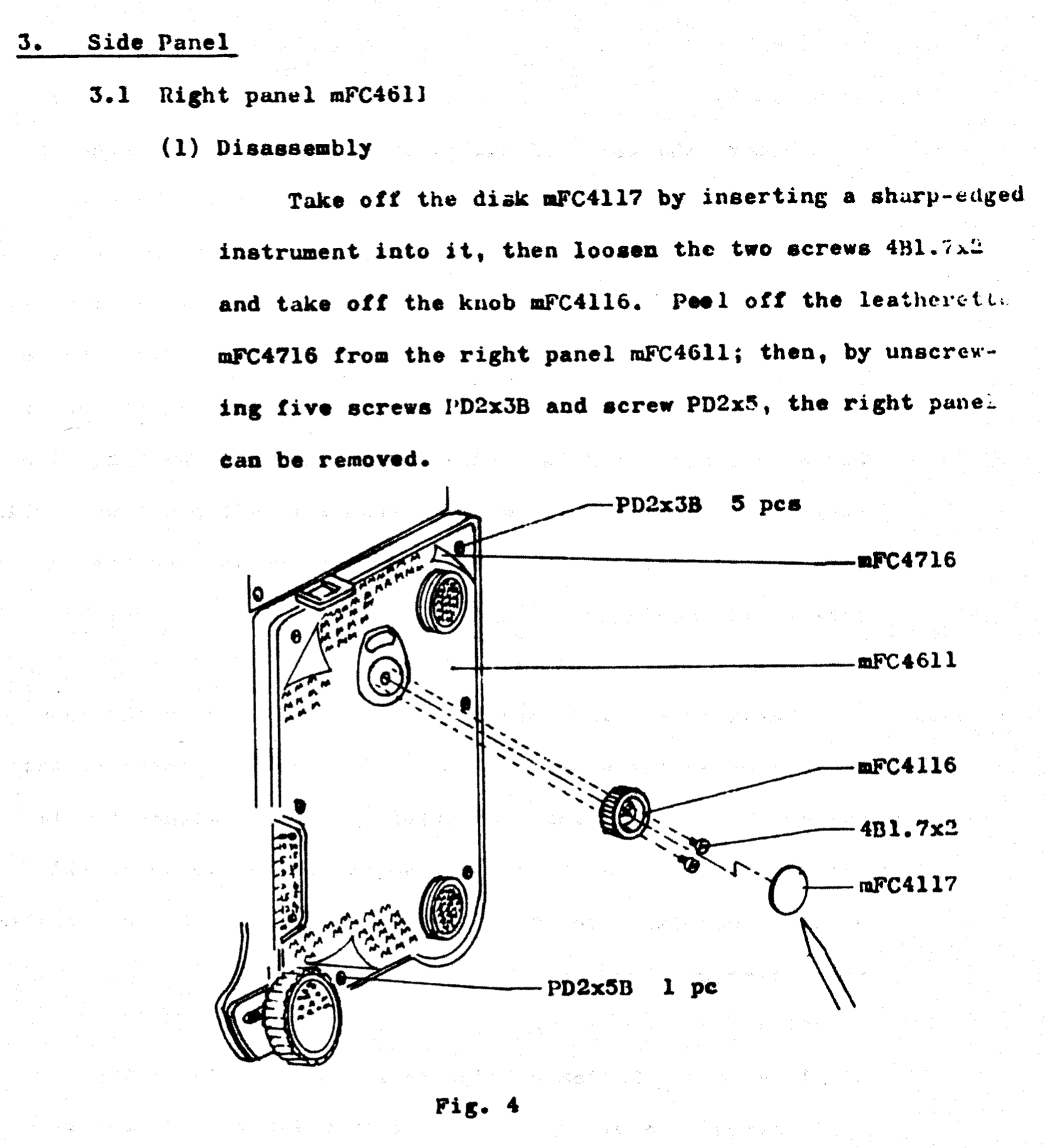

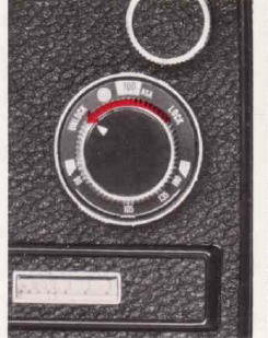

My Mamiya C330F lens change knob is kinda lose. Tried to remove the cover so I can tight the screw that held it together but so far haven't been able to remove it.
Any tip?
I mean this piece
Thanks

You need to soften the glue, you can first try alcohol (apply on the edge using a syringe), if it doesn't work use acetone, let it act for some minutes and then try removing the cover again.

Judiciously applying heat often softens up the leatherette adhesive. A hair dryer or heat gun will do it.
