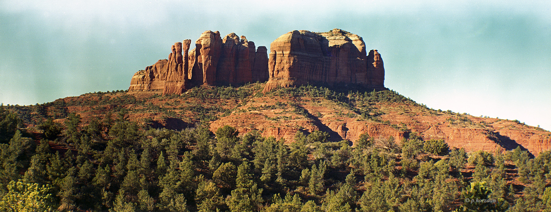

de Rest of the Story ...
The soaked away image made it interesting, especially as it was taken with a 1914 Brownie, converted to 120 film. Haha.. don't think I will try it again though.

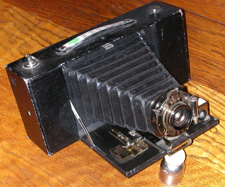

Excuse me peter k.,
just out of curiosity: Brownie model?, ratio used with the 120, or is it a crop? Thank you
Its a Kodak 3a folding Brownie..
There is film in it, so I could not get the number for you, but when received from a friend, who's grandfather used it, researched it and found it had been manufactured in 1914.
The only crop on the photo is about a .25" on the left side, as the picture before it overlapped this one.
You can only get five shots to a roll.. I have no idea what the format is in the the terms of 6 x ??, but it originally used "PostCard" 3.25 x 5.25 film, which was no longer made in the '70's, and so converted it to 120.
The difficulty comes when you wind for the next shot.. there is a 'red' viewer on the back, but of course it has nothing on the backing paper to align up to. So I have worked out how many turns for each shot.. and masked part of the viewer so as to frame the shots.
Makes great panoramas.
http://licm.org.uk/livingImage/Kodak_No3A-Folding-Brownie.html
Thank you for the info. peter k. (don't worry about the number)
I think that model was introduced in 1909 (up to 15), if the shutter is F.P. Auto (1909-13) Brownie Ball (1914-15) Indeed it was postcard size (film 122) with 8.24 x 14 cm, so you can get five shots 6x14.
Nice one!
