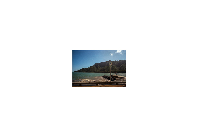

My latest scans on my Epson V700 had a red line running across all of my scans. This was the first time scanning film from my new 3d printed 6x9 camera. The red line was in the same spot on all frames from two different rolls of film. The film was commercially developed on different days in the same lab. My first thought was a camera scratch.
I could not see the line on the negatives. I switched to a different negative holder which put the film in a different spot on the scanner and the line went away.
the scans that had the red line were held in a Epson v850 carrier with anti newton ring material. I used this holder before on my 6x17 negatives with no problem.
The 6x9 scans without the red line were held in a regular 120 carrier that holds two strips of film.
Any thoughts on what caused this?

I see a tiny, tiny, tiny little image with something that may or may not be a horizontal line...
The red line
Longitudinal lines that are pure red, green or blue often relate to a problem with the scanner's sensor or a calibration issue; either a defect in the sensor, dust on the sensor, or dust on the calibration area. Start by cleaning the calibration area, then take it from there.
Sorry for the small image, hard to get a correct size on my Ipad with Light Room.

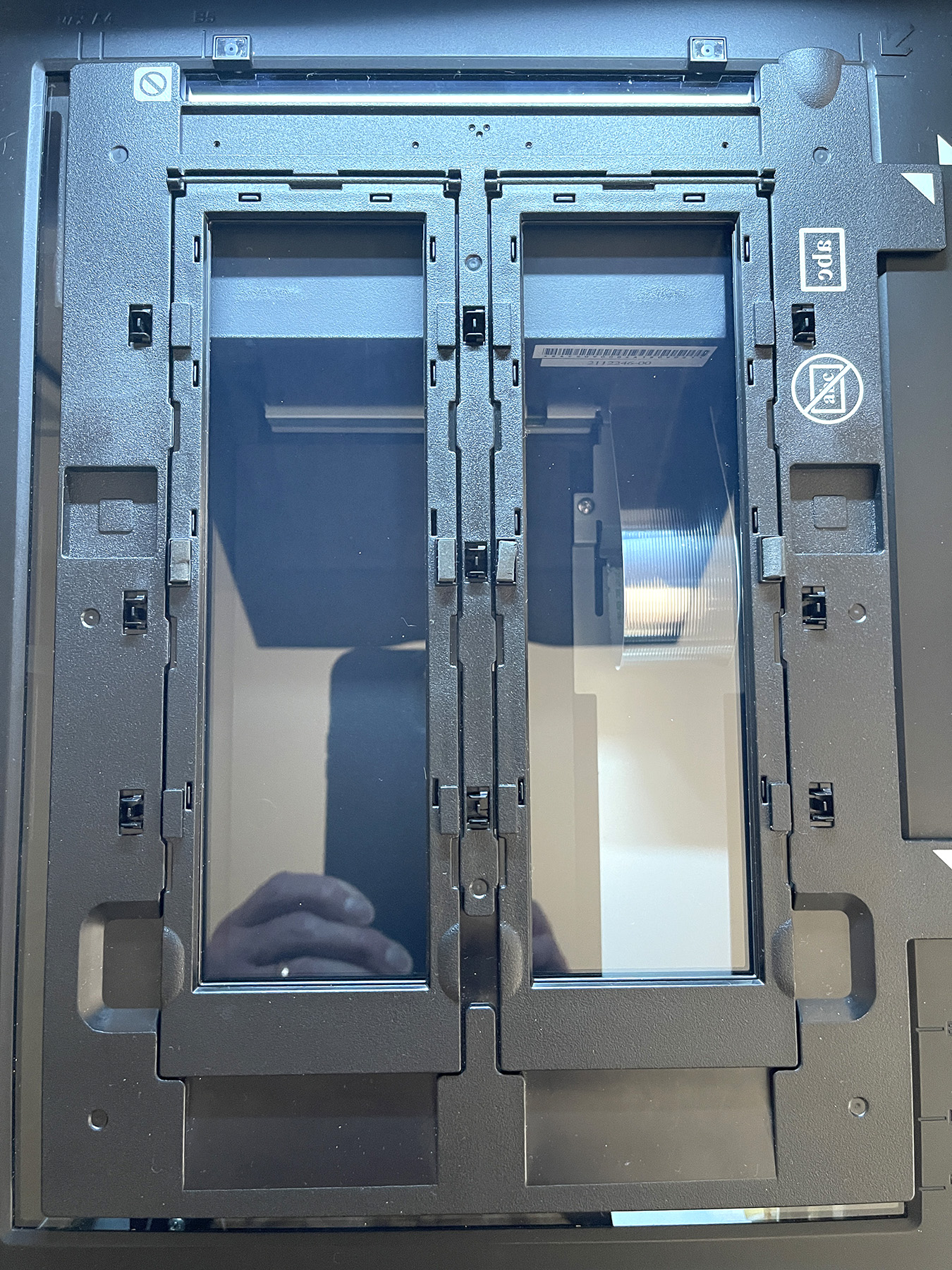

So your regular 120 carrier looks like this when placed on the scanner:

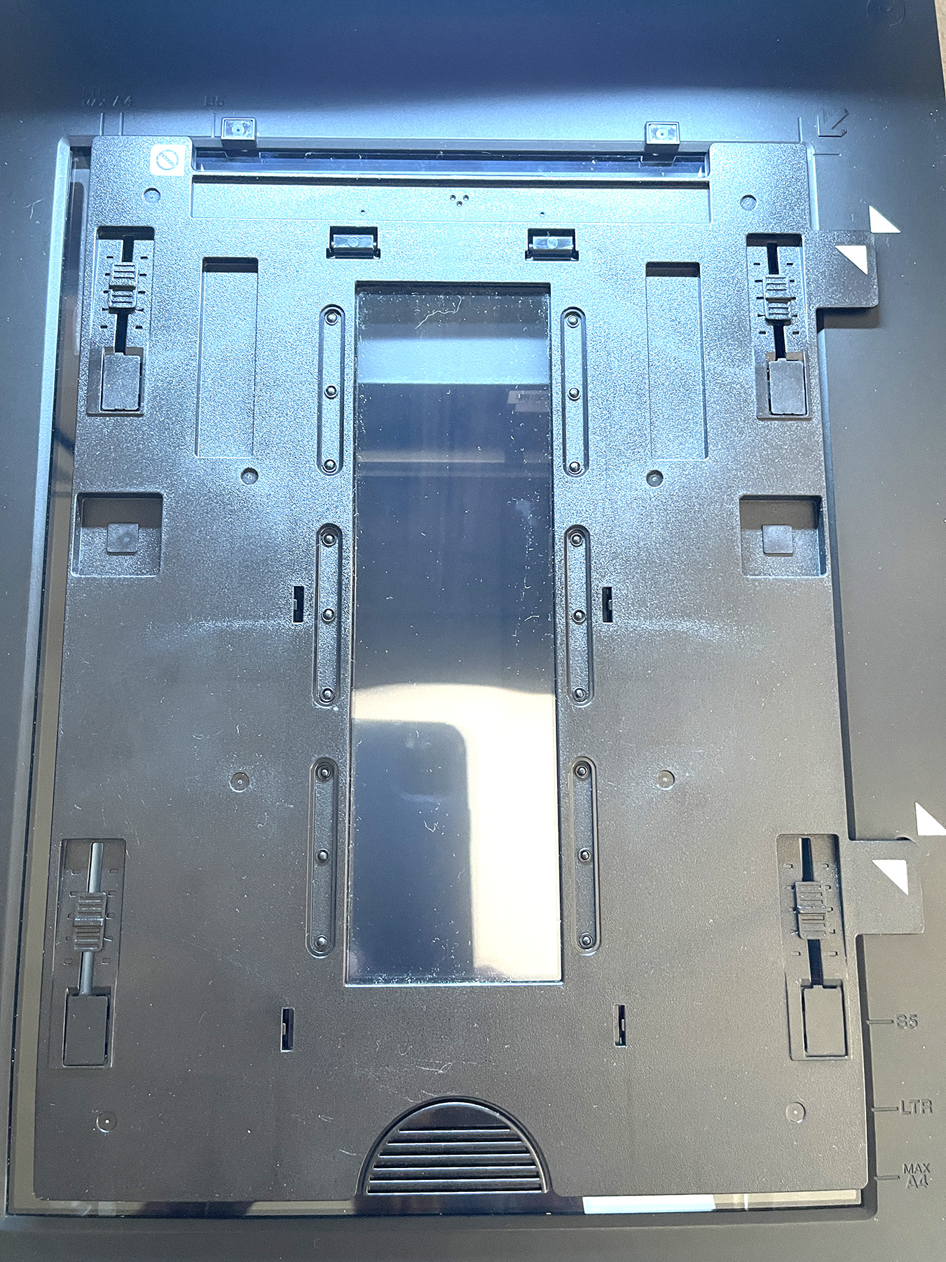

and the V850 120 carrier looked like this on the scanner bed?
The calibration area is the clear rectangle that shows up at the top of the scanner bed. And in both cases, the white triangles of the carrier should line up with the white triangles on the scanner bed.

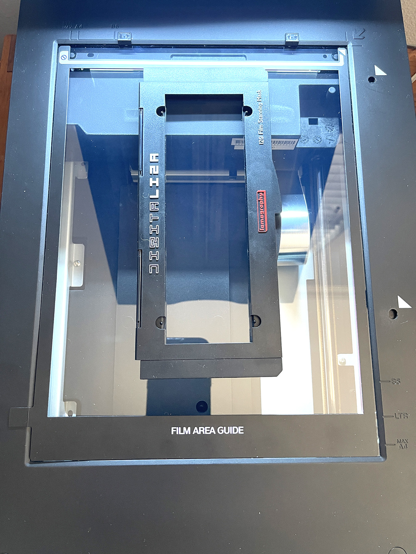

I scan 6x17 negs all the time using both negative carriers on a V750 scanner with no problems. I also just tried using the Digitaliza 120 film scanning mask (using the Film Area Guide) to scan 6x17 and it worked pretty well too. That arrangement looks like this:

As Koraks notes, dust can and will get into your scanner over time, but I don't think its a dust problem. That calibration area needs to be clear at the very top of the scanner frame. The V850 carrier with the anti newton glass is a different beast from the v700 negative carriers - after loading the carrier you flip it over onto the scanner glass, make sure the two short "pegs" align into the scanner bed, and the two sets of white triangles should be pointing at each other. Is that how you scanned your 6x17 neg?
