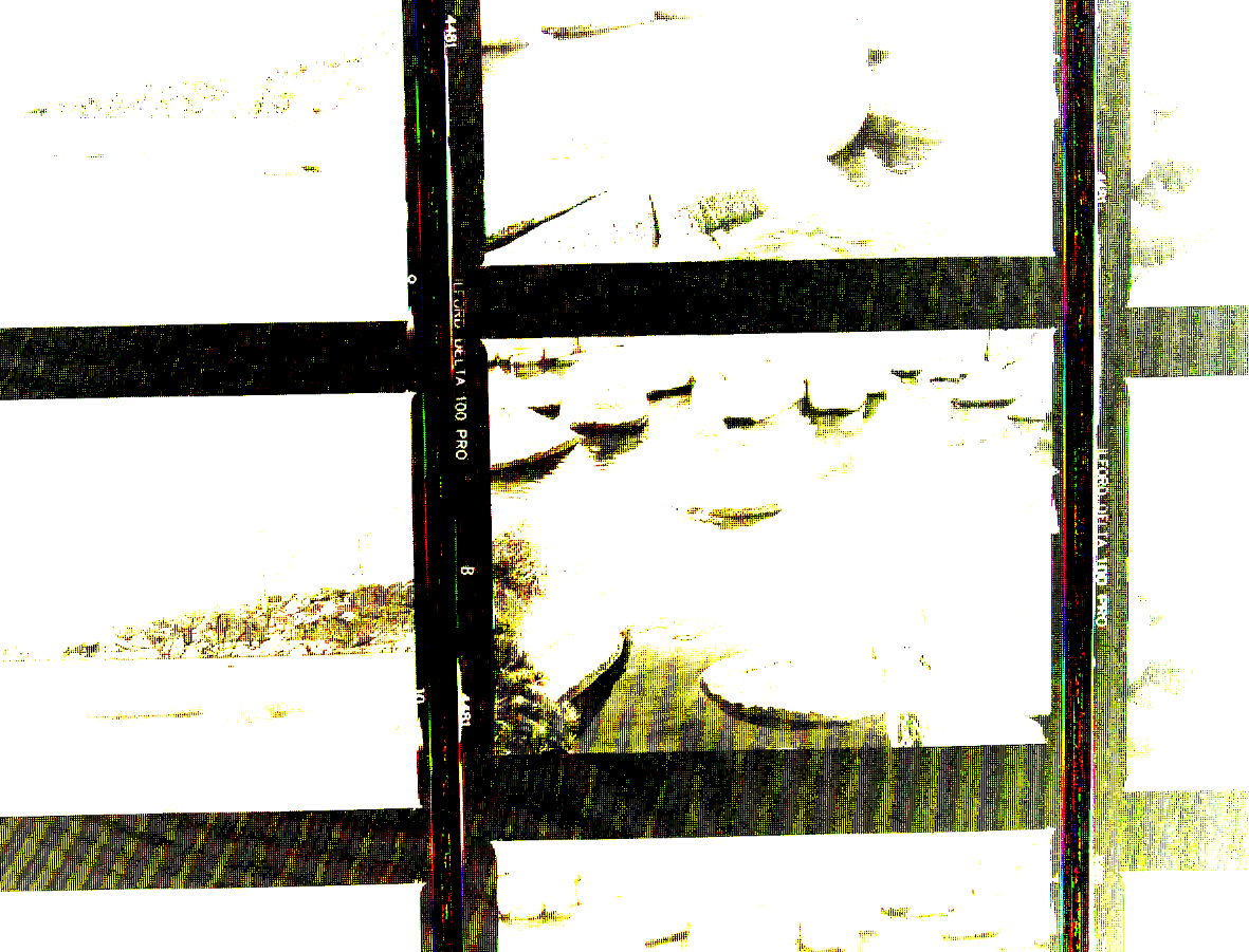

I pulled your Sample 1, 4 and 5 "contact sheets" into Photoshop and looked at your shadow details to judge exposure. This relies on the idea that the clear part of the film between frames will be the max black in a print. Nothing in your frame will be able to print blacker than this. It also implies that there is no detail in this area.
What I do with Photoshop, though many editors will work the same, is to first invert the images to positives. Then adjust the curves or levels and move the black point while holding down the option key (Mac, alt on WIndows?). This shows the areas that are being clipped to black. As you move the black point you will see the unexposed areas show as clipped. With the Sample 1 photos I see significant areas in many frames turning black at the same time as the blank areas around the frames. This tells me you are underexposed on this frame. You should probably rate your film slower if those areas should have detail (looks like they should to me).
Doing the same with Sample 5 I see the opposite issue. Nothing in the frame is even close to as clear as the blank frame. This indicates you over exposed. This will cause the grainy image issue you are seeing. I would guess that your iPhone meter is already taking the snow into account and you didn't need to add all the extra for the snow. The nice thing with the iPhone metering app I use is you can see the exposure effect on the phone and adjust the metering point to account for that.
Looking at Sample 4 these look perfect. Small areas of max black start emerging in the frame at the same time the interframe areas clip. This is what I want to see as it gives good shadow details with minimal grain (and lets you maximize shutter speed to reduce subject movement).
I would first correct your exposures by adjust the film speed for your working conditions (mainly developer and metering technique). I found Delta 100 was closer to box speed than Delta 400 with XTOL (similar to DD-X) so just be aware that a one sized fits all approach of halving the speed isn't perfect. You might find Delta 100 is really best at 80 and Delta 400 is best at 200. But halving box speed is usually where I start and then work up from there as it's safer. You can use the photoshop technique or just a loupe on the light box to evaluate underexposure, but I find the photoshop black point is the easiest way to gauge the degree of significant over exposure.
I see nothing wrong with the iPhone light meter app I use (Pocket Light Meter), but you need to be aware of how it works. I tend to avoid including bright clouds in the metered area. It behaves like a cross between and incident and spot meter. I still prefer my Pentax spot meter, but like you I appreciate not carrying it (or pointing it around a city as it looks like a gun to some people).
After you are happy with the exposure details you are getting see how the negatives print. I aim for a nice print on grade 2 paper as this gives you room to correct in either direction. My guess is you are close on the development. But if you need a higher grade to make a nice print add more development, and if it's too contrasty subtract some. 10% time adjustments are usually about right (convert to seconds to make the math easier).
One other observation, you seem to shoot whole rolls in the same light. So you really could use zone system development techniques in your landscape work. Just try to finish the roll before the changing the light significantly.

The scans aren't my concern. 95% of my negatives that I scan, I can get what I want from them, more or less, via Lightroom. I'm just looking to make my negatives better for darkroom printing.
I might give this a shot when I have the chance. And, I deliberately us a red filter for darkening the skies, I like the end result when everything else comes together correctly.
That's what I was thinking of doing but I wasn't exactly understanding what was written when it came to the shooting and development settings.
The only paper I use at the moment is Ilford MG IV RC Pearl. I use a diffusion enlarger with a color head for filtering. I use Eco-Pro's printing chemicals and develop for 90 seconds, stop for 30 seconds, and fix for 2 mins. I usualy do split grade printing. I can reach a point of getting the darks and highlights where they need to by adding contrast but sometimes it seems like I have to take it to such extremes to get them, that I end up with an overly grainy print and something a bit harsh looking. While other prints just seem to come together easily with good tones, cleaner grain and less harshness (simply put, cleaner/nicer looking).
I'm not sure which samples are being refered to but, the shadow details were a bit lost and darkened when I photographed the print with my digital camera. I don't have a scanner that can fit 11x14. Some of the prints in person, have better shadows but with room for improvements. The last sample is more reflective of how problematic the actual print is.

I'm not sure if this would have altered your test but my "contact sheets", I was a bit lazy in sharing them. I left them in the plastic sleaves and lade them over a white comptuer screen. They weren't pressed flat either. I simply photographed them with a camera. The 2nd photo is a digital scan of the negative that is "neutral" (no alterations made in the scanner software or lightroom). In any case that can be another way to evaluate the negatives. I imagine scanning the whole strip (to include the unexposed areas between frames) can be used in such tests to achieve the same results.
I haven't tried printing sample 1 yet, though I would like to.
Sample 5 I might have overcompensated on the number of stops of light I gave. In hindsight the snow wasn't as dominate in lighting/metering of the scene as I had expected.
I use the Lumu Light Meter App. Perhaps I can give Pocket Light meter a look to see if I like its interface.
Maybe I can play around with the zone system a bit. Though, I take 90% of my photography while hiking and my hikes are all day excursions so, it can be hard to expect the lighting conditions not to change sometimes. The samples I gave were days where the light and weather were fairly stable.
My "darkroom" maxes out at 11"x14" and it's what I usually print at. Sometimes 8"x10".

It doesn't make much difference if you just look at the blank film around each frame you're comparing, but across the whole roll it was quite variable. If you use a real scanner it will be better, especially if you mask off any areas outside the film.
