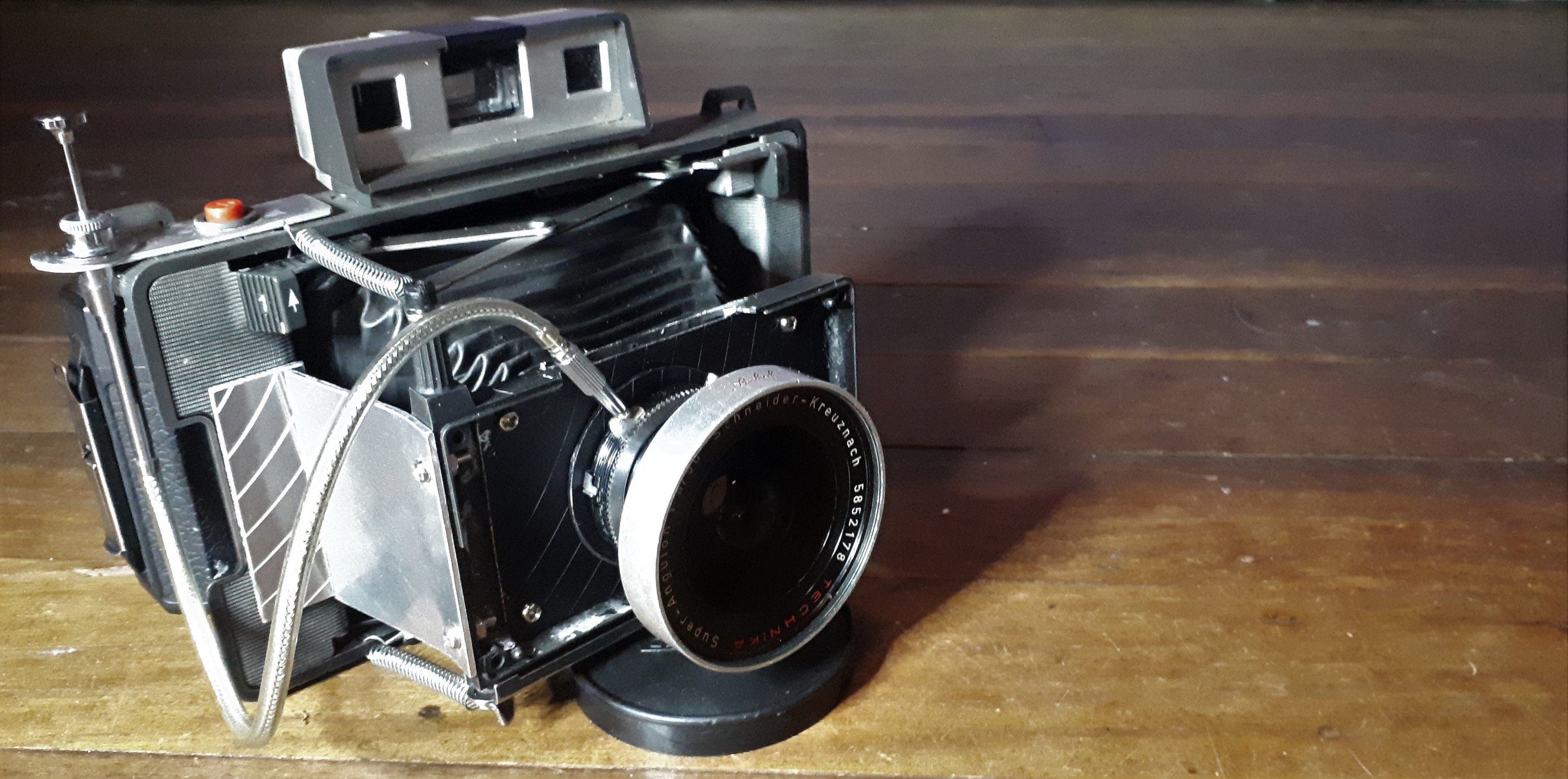

I use a 90mm S-K Angulon f6.8 that barely covers, in fact mines a little off center so it doesnt. You could use a super to get sharp corners. Not sure about your fuji, but is worth trying if you already have one. I personally prefer a 90mm or wider, other wise it will look too much like a crop.and not so panorama. But then you need to adjust bellows to suite, not hard, wides are pretty forgiving. I used a 330 Land range finder, but after picking up a zone finder 104 I think its better (people give these cameras away), certainly easier as the guides are in the view finder window. I just butchered a 612 holga pinhole to use as a film holder and bolted it on the back of the Polaroid (lots of butchering). The camera has some focusing issues I will need to sort out.....still very cheap to make and very light, just came back from the city after taking mine out for another test run.

Cost of mine was $100 for the lens, $100 for the Holga and $20 for the polaroid. Thats Australian dollars, which is about $150 USd. Cant even buy a 6x12 film back for twice that. Wouldn't be hard to adapt the forward standard to take a lens board if you wish to switch lens.

They look great, not too expensive, but much more fun to make your own 6x12.
