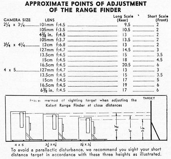

The side rangefinder can be recalibrated to whatever lens you've purchased, but I think for a studio portrait camera, that is more trouble than it's worth.
The most common side rangefinder on Speed Graphics is the Kalart which can be calibrated for lens from 101mm to 165mm.
