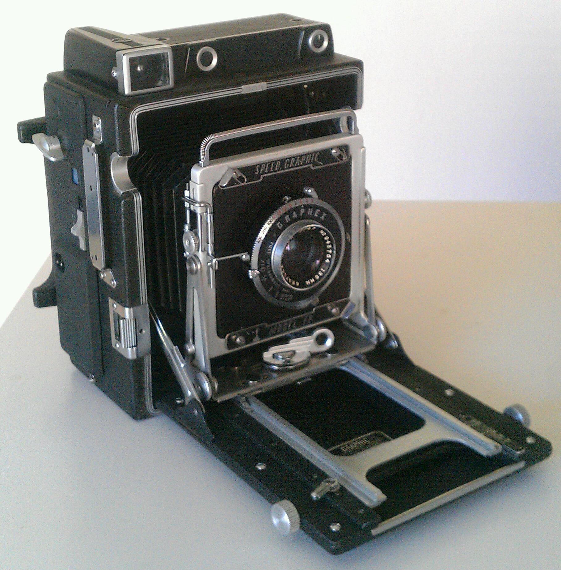

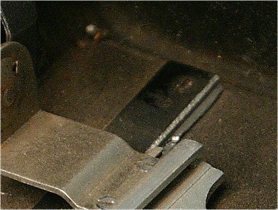

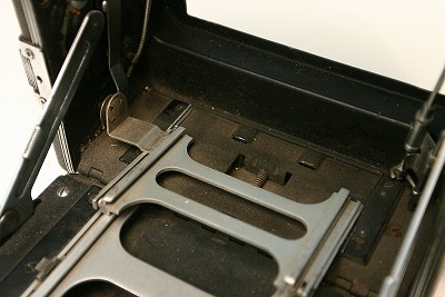

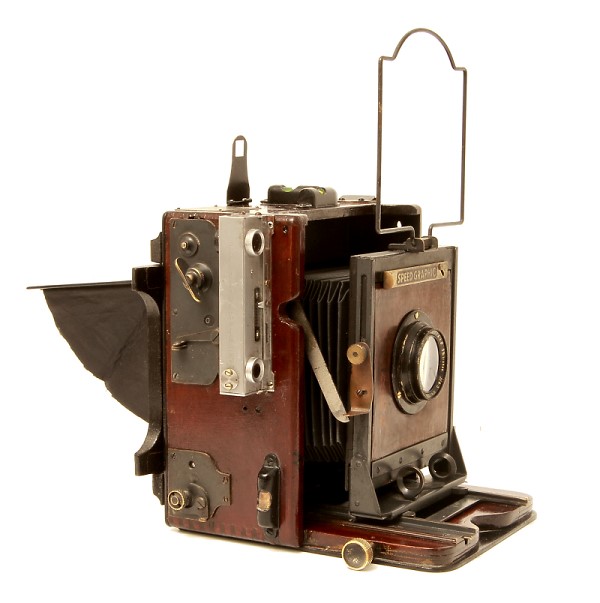

I bought this as part of a pair on Ebay, the seller said there were enough parts from 2 Speed Graphics to restore one good camera. In fact this one was a pre-Anniversary Speed Graphic modified from new as a WA camera, so the rangefinder is set up for a lens of approx 90mm, and part of the case cut away at the top.
The second was a Pacemaker Speed Graphic missing all it's shutter parts, aside from needing re-covering the rear rail guides were badly damaged and useless. I found a new set on Ebay.
Parts for Pacemaker Graphics can be quite expensive now on Ebay with one or two sellers stripping cameras and getting far more by selling the parts rather than complete cameras. But I'd suggest to DaCosta that they are relatively simple to restore.
