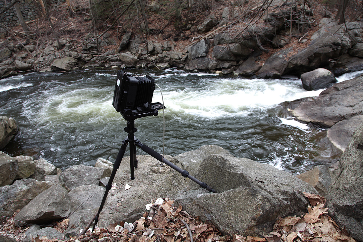

I picked up a carbon fiber dolica with ball head at Costco for hiking. It can hold my Canon SLR as well as a Toyo Field 45A, albeit not as solidly as my Manfrotto 3021/3047 combo. I prefer lever locks so I'm not thrilled with the rotating ones on the Dolica, and it's four segment not three, and not as tall as the Manfrotto, but a fraction of the weight and height when packed. For how I use it, I can live with the trade off.

FWIW, my Toyo 45A-II on a cheap Dolica carbon fiber tripod. It's much easier to pack into the woods than a Manfrotto 3021/3047 combo.
