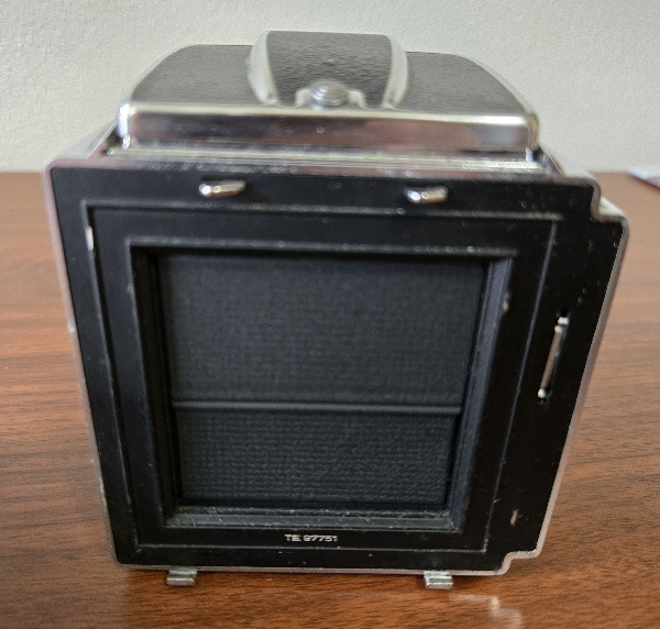

Hello all, and thanks for fielding my questions. I recently acquired a Hasselblad 500c camera that I'm looking to sell. The problem is, I have no idea how to test the functions other than the shutter so that I can properly describe the camera when I list it for sale. I'm not sure if there's anyone local to the Rockford Illinois area that would be willing to take a look at it for me and test it out, or people here that could help me with some tips on what to look for / at. I appreciate all responses - thanks for your time and patience with me.

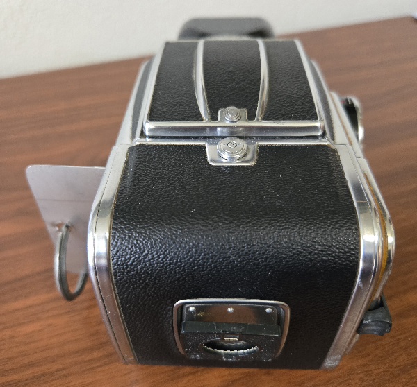

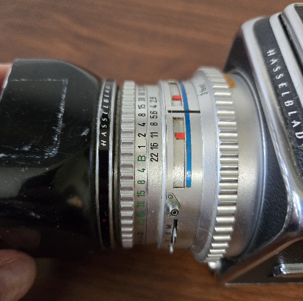

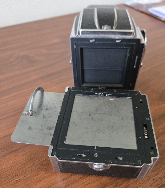

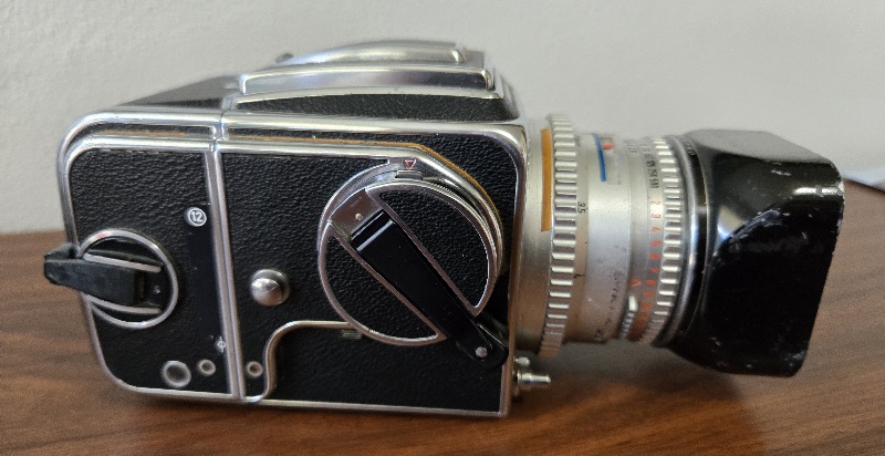

You should know from the start that you have a very beat up Hasselblad, with a non-standard replacement dark slide in the film back. But at the very least, you can test out all speeds of the lenses by dry firing and looking through the back of the camera body with the film back removed. Since the aperture and shutter are both in the lens, this will give you an idea if the lens works at all. The 80mm Planar lens looks a bit odd, but again, test out each lens on the camera body and fire it through all shutter speeds. If it appears to work, then shoot some film with the camera to determine if you can even call it functional. If it is not functional, then the best you can do is sell it "for parts" which is why you need to test it out.

As @djdister points out, you need to actually run a real roll of film through it to know whether it can be sold as working or "as-is". One of the issues with this type of camera (and frankly with all film cameras) is that without film everything may seem to function, but with film you may find a light leak in the back that ruins the film, or a shutter speeds that are far from the what they should be that makes it impossible to accurately set exposure.

There appears to be a problem with the flip-up magnifier in the waist-level finder...it is taped down with what looks to be dried-up masking tape.

What the cr@p is that dark slide with a ring? That's a red flag. I suggest you order a replica slide of the right shape and size.
While I won't disagree, that ring looks like the sort of modification that might enable use for someone with less than typical two-handed dexterity.
I used my Mamiya C330 for years with a modified film wind lever for just such a reason.
It was only when I stopped photographing weddings that I re-installed the stock lever.

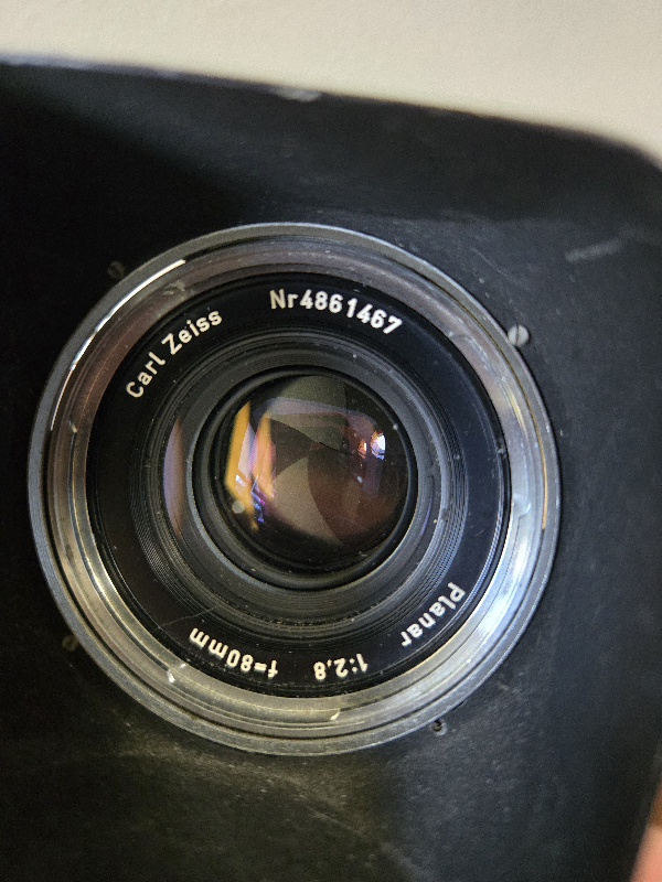

The service history would be great. Otherwise I'd expect the typical things. Inaccurate focus due to deteriorated pads behind the mirror, Deteriorated foam, Mirror damper decomposed, causing inevitable jams. The mechanism of the camera body is actually quite simple. Yet at the same time requires periodic CLA. The lens needs CLA also, I'm sure.
Frankly, it looks like that Hasselblad has had a hard life and the things F4U mentioned are likely to be true. If you want to minimize cost and effort, just sell it as is, untested. Someone will want it.
Like many here I have purchased “untested” gear. I think most of the time I managed to weed out the sellers that were lying, but I also figured most of them need a clean/lube/and adjust and factored that cost into what I was willing to pay. You can start an eBay auction for $1 and you’ll get what the market will bear, especially for an in demand item like the Hassy. I did that once with an unusual movie camera lens and was shocked with what I got for it- started the auction at $1.

Can you try cleaning the exterior? And remove the blue stripes on the lens, and the orange/gold stripes on the body?
if that bothers the buyer,let him or her replace it. I suggest not to make additional investments prior to a sale. they arerarely economical. The camera as-is should still fetch around $1,000.
