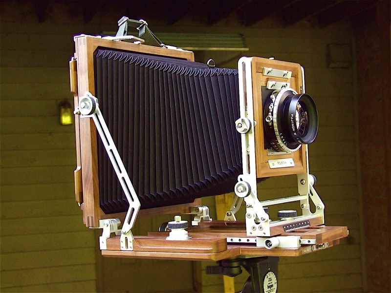

I have to plug the Chamonix since no one else has:
Can handle a 75mm without too much trouble-- minimum draw is 45mm(!). It can handle a reasonable range of movements at 75mm, but not extreme unless you get the bag ("wide angle") bellows.
