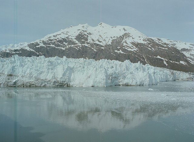

This image was taken on the Mamiya 645, in total I shot 4 rolls of 120 film and each of these films has both of the vertical lines on every frame of the negative; the imperfections are also seen between frames on the negatives. You can see there are two vertical lines, one to the nearly far left of the frame, the other almost pretty dead on center which is less obvious.

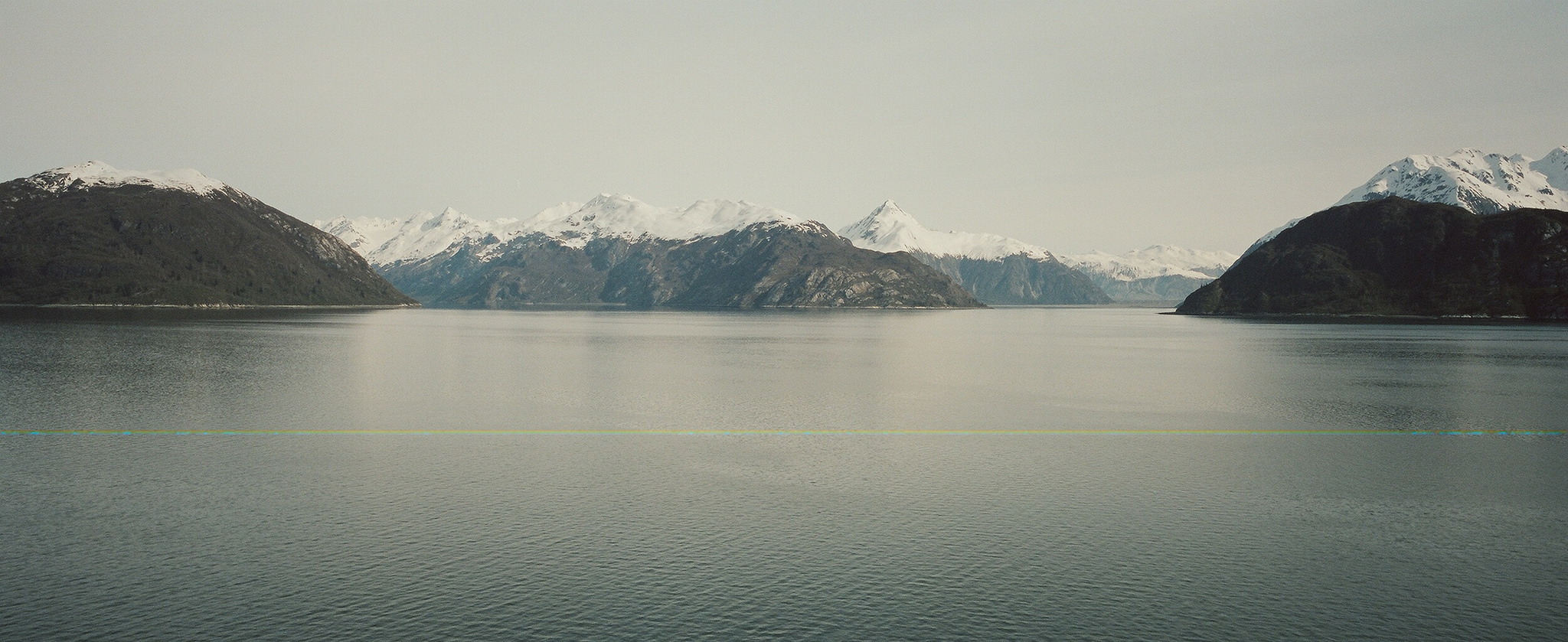

I also took some shots with a Hasselblad Xpan, these have horizontal lines which the source totally bemuses me. I only took 1 film on this camera but all frames from this film have this issue.
attachment.php
I know that this equipment was working okay prior to me getting hold of it what are your impressions of these results?

have you looked at the actual film to see if it is a film processing camera issue
or a scanner issue ?
not trying to be a smart Alec just ruling out possible things ..

Doesn't look like camera faults to me. These tend to be: light leaks - show up as white streaks on prints and black streaks on negs that usually extend outside frame area, shutter capping usually shows up as black bars, scratches - pretty obvious continuous lines across negs. This looks like processing images - maybe just on prints and negs might be fine. Look at negs with a magnifier. Perhaps have them printed again somewhere else?. Also shooting snow scenes is more difficult than most scenes as lots of white snow fools the meter to under expose. When shooting snow overexpose 1 stop as a guesstimate, or use an external meter.

xpan line looks very much like a scanner fault (bad scanner sensor). I can't tell from the 120 neg but its probably same fault. If you can't see the lines on the negs with a loupe then that will confirm its a scanner fault.

The lack of Contrast and Colour is UNDER-Exposure of the negatives -- you didn't allow for all the light toned sky and lots of white in the subjects -- not sure about the 'lines' though -- I don't get them with my processor here in England or when I do it myself as I do with my roll-films. Next time use gear that you KNOW and take time to TEST out your film cameras before going on an expensive trip !

Try to scan the negative in 90 degrees opposite direction, and as other already stated - try to analyze the negative under the loupe.
The line on the one image looks like light leak or a scanning issue. Try scanning at another angle or even upside down from this placement to see if the streak moves or remains the same. I've had faint lines like this after a scan and it was the scanner that needed cleaning.
